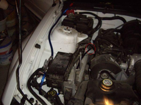

Something I have never seen before, wondering if anyone has any experience. The gromit in the firewall from the inside of the car seems to run through a channel or something of the sort, and then runs out of another gromit into the engine.
Normally, I would just pop a small hole in the gromit, and feed the wire through, but for this mustang, I am having issues. As i run the wire through, either one of the gromits, they both seem to hit a wall or something, and I am unable to feed any more of the wire through. In addition, no wire is visible through the other side.
Anyone have any experience with a 2007 Mustang?
Thanks!

I have an '05 Mustang and I ran my wire through the grommet to the right of the battery. It's down a little bit on the firewall behind a rubber sack thing. You have to put a hole in the foam on the inside of the firewall, but don't worry, there's nothing there.

No, the fuse holder is just sitting next to the fuse box. I ran the wire like that because the amp was behind the front seat. This way I could leave enough wire to run the amp to the trunk in the future.
