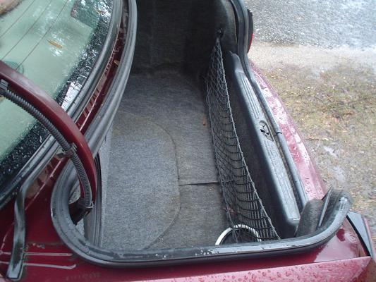

She wants a little bass, and plenty of room to put groceries. Also no wires or equipment hanging out like most drop in installs.

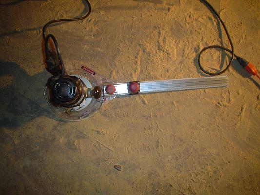

That's what I got done before the table saw died. I finished the cut with a circular saw and packed up for the night.

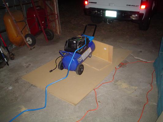

I left my air compressor on the wood to see if I can help get it a bit flatter.

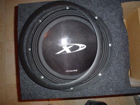

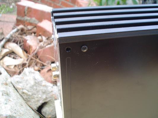

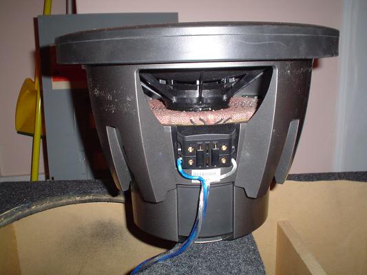

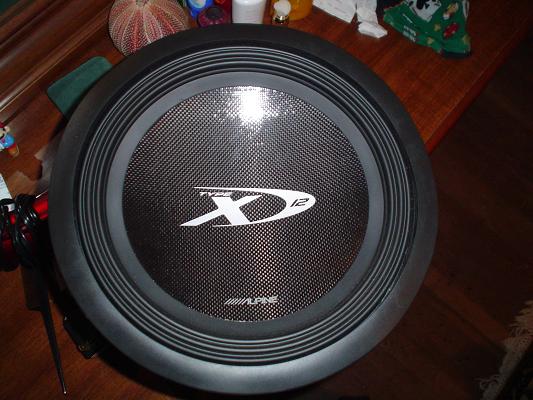

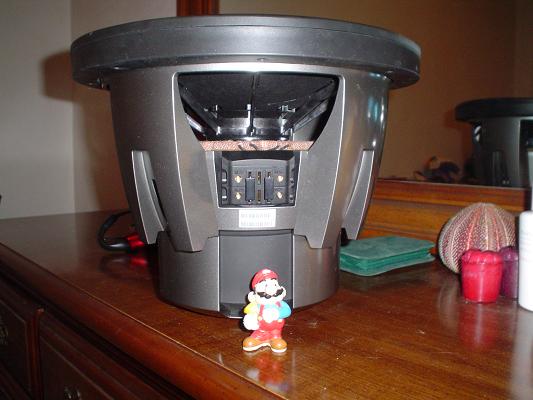

Oh, and here's a few pics of the equipment:

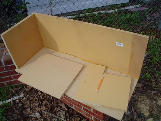

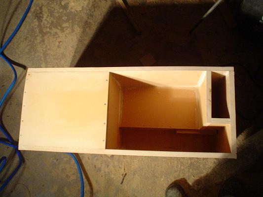

Okay, more updates. I hope to have this finished today, I had to go to Lowes and some other things, only got a little more work in so far. Then I had to set up the new table saw and all that.

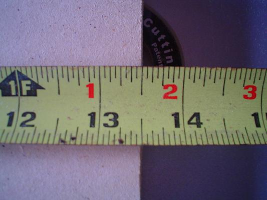

Being right on every cut, priceless:

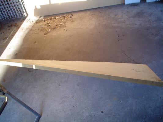

I love using a tablesaw.
Just getting all the pieces cut.

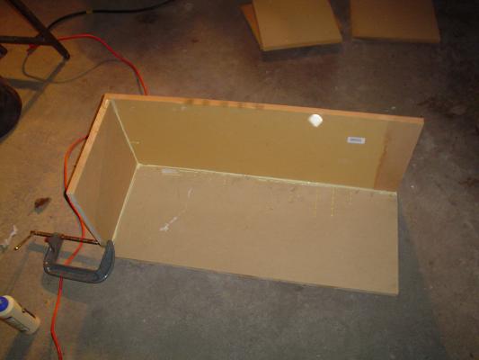

And finishing assembling the 'box' portion.
A note to anyone not using good wood: go buy good stuff!

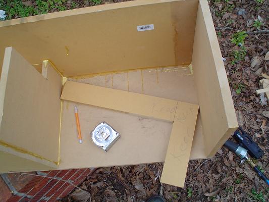

This wood splits really bad, so every pic that has a clamp in it is where even though it's been predrilled it splits. With some glue and a clamp it's fixable, but really time consuming.

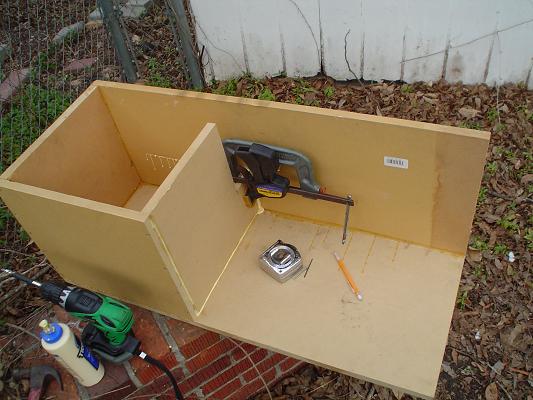

Starting the port
And getting ready to put it in place. Like I said, the wood is so warped I'm using screws and I forgot how much longer that takes than finish nails. Each screw is literally bending the wood back where it should be.
And about to attatch it:
Thats where I am now. Just to put the top on, cut the hole, cut the hole for the cover, and put the 'amp rack' part in.

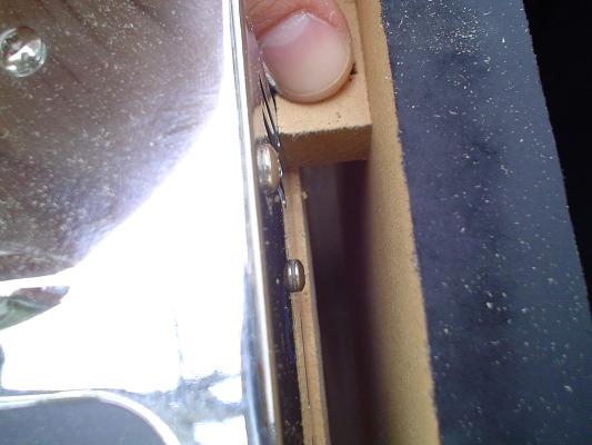

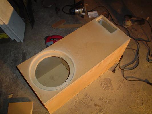

Had to sand out a few of those lumps from the warped wood after attatching the port, and caulk the hard to reach places before they become impossible to reach places:
You wont see anything but the equipment and the port opening, so the excess glue is just a plus and less when it comes to sealing things tight to me.
The product so far:
I'm putting a 3/4 round on the trim panel so no need on the port. I had a bit to sand, but it'll be good once a bit of bracing brings things together.

This compares my wifes entire box to my port, which is why I say it's small:

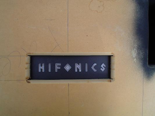

Cutting the holes for the sub, and the trim plate. There's still dust in them, so dont mind the rough looking edges:
Router ftw. I will never cut another sub hole with a jig saw, it's just too time consuming and this works sooo good. I think the minimum hole size is 10", but it goes up to 40-some.

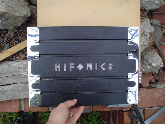

Just test fitting the equipment (no I don't plan on screwing the amp into the port, it will have an amp rack).
And the baffle
And after cutting the port out, a nice 3/4 round on the beauty panel:

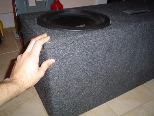

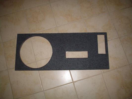

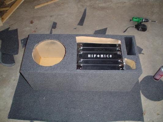

I talked to my wife earlier and she really doesn't want the amp displayed like I originally planned. Neither of us like neons (the amp is lit up blue like that). Atleast I have a nice place to hide the amp so there's no wires hanging out.
So tomarrow I carpet with black carpet (generic, nothing custom about it) and throw it in hopefully.

Painting the port and around the sub opening: Upload
The Bracing/amp rack begining
The amp had no means of attatching it?! normally there are places to screw in, but there was nothing on the amp, or in the box (and I bought it new). Had to get a little creative.
Heres the platform for the amp
Putting the platform in place, it has plenty of room on all sides for the air to circulate. Theres a pic of the block holding it in place at the top.
closeup of the block and how snug it holds the amp
The block in question
Coming together, I got the hole cut for the logo to show through
A bit closer shot

Test fitting with the amp in place
Carpeting the box
And the trim plate
And all carpeted
And with the sub sat in to test fit
Still have to screw the trim plate in, but I'm waiting to hook up all the wires and test everything. Then I'll have to tune the amp too, so just sitting it on for now.
Wiring it up. It's so simple, those jumpers really make for a clean appearance.
Screwing it in place and putting the rubber cover on. Kind of unique, not many subs do anything fancy, I'm sure that's why my wife likes it lol.

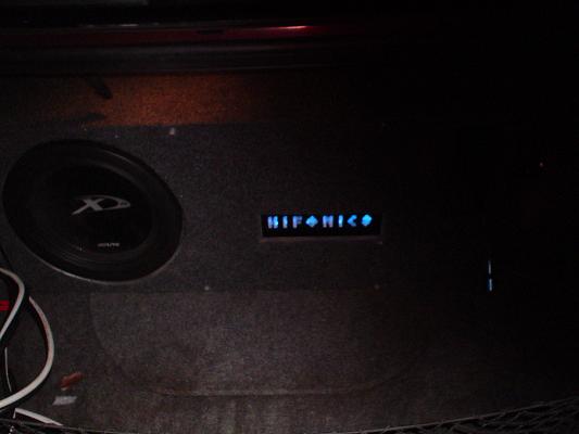

Okay, final updates until I meter it.
Here's a shot of how much trunk space she has:
And a few of it lit up at night. It's very hard to capture, but it gives a general idea:

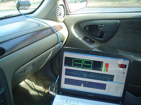

Okay, here's the meter pics:
Sealed dash
Sealed kick
It hit 39-39.1 as long as I played with it on the dash, so I'm fine with that. Like I said, it's a single 12 on 1krms in a trunk- I'm fine with it.
