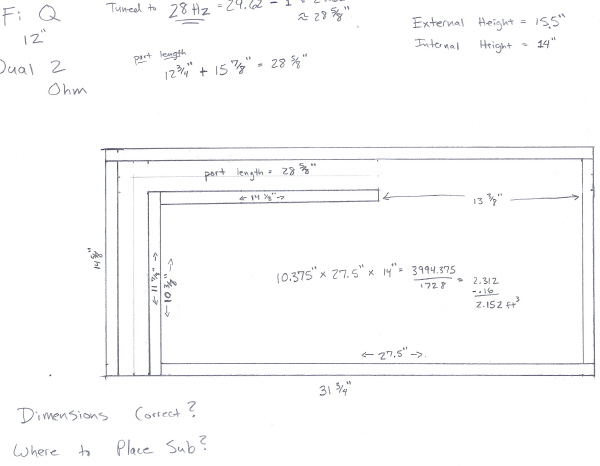

Bronze Member Username: 2000celicaRoanoke, VA U.s. Post Number: 80 Registered: Jan-08 | ok so here is the ported box enclosure i drew up for my Fi Q. i just have a couple more questions and i should be good to go with this box. 1.) when measuring cubic feet of the box, do you just measure the area where to the sub is, the "main" part of the box, or do you also take into consideration the area that the port has?? in the drawing i just got the volume of the area where the sub is, not counting the port itself at all. 2.) my sub should be mounted on the right side of the box? so it is right in front of the port opening? i was thinking of mounting to it dead center. i know that most are more to the right side though. 3.) do the dimensions on this drawing look correct? as far as making it 30 Hz, if you think I should do that i can just shorten the length of the port and it will drop it down to 30 Hz. oh and bracing. i'm guessing i should brace a box of this size. my question is how many braces, and where should i place them? i was thinking of doing 2 pieces of mdf using them like pillars, one of each side of the sub, as proportional as possible. good idea or no? ![]() |

Gold Member Username: InsearchofbassPost Number: 7936 Registered: Jun-04 | "1.) when measuring cubic feet of the box, do you just measure the area where to the sub is, the "main" part of the box, or do you also take into consideration the area that the port has?? in the drawing i just got the volume of the area where the sub is, not counting the port itself at all." Right you only count the usable area the subwoofer is in minus the subwoofers displacement not the port too but you made a mistake you fogot to include the area after the port 13.5 wide roughly by 2.75 deep by 14 high 519.75 equals .30 more in usable internal volume...also I looked on fi's website for the fi 12 q and the displacemnt for the sub is .12 no big deal though so we have 2.19 cubic feet net plus the .30 thats 2.49 cubic feet net but your port length is wrong using a 2 x 14 for a 28 hz port tune you would need a 33.25 port length but with end correction it would be 32.25 but with 26.5 inch long port which your drawaing looks like its showing plus end correction youll have a 30.36 hz port tune 2.) my sub should be mounted on the right side of the box? so it is right in front of the port opening? i was thinking of mounting to it dead center. i know that most are more to the right side though. mounting it to the center will be fine 3.) do the dimensions on this drawing look correct? after my corrections like I said youll have 2.49 cubic feet net |

Gold Member Username: InsearchofbassPost Number: 7937 Registered: Jun-04 | you can add bracing if you like but it will take up room inside the box as long as you dont use too much it wont change things much in that reguard but putting bracing in the corners where the sub gets its airspace will be good (the four corners.. im not talking inside the port ) that should be good enough |
Gold Member Username: InsearchofbassPost Number: 7938 Registered: Jun-04 | if you change the size of the usable area for the sub the port tune will change if you give it less the port tune goes up with the same port size if you give it more the port tune goes down with the same port size |
Bronze Member Username: 2000celicaRoanoke, VA U.s. Post Number: 89 Registered: Jan-08 | the port length now in the drawing is 28 5/8". the total area, counting all space is 2.45 ft^3. i am going to shrink the box by one inch of the depth and on the width. doing that, counting sub disp. will give me the 2.15 ft^3 i was looking for. the height, 14 inches, will remain the same. when i do this, how long will the physical port length need to be to achieve 30 Hz? (sorry for bugging so much, i just want to make sure everything is correct) |
Bronze Member Username: 2000celicaRoanoke, VA U.s. Post Number: 90 Registered: Jan-08 | my head hurts... ok so i keyed in the sizes into WinISD and for the measurements i gave it, with 2.31 ft^3 for 2.15 after sub disp. it gave me a port length of 29.7" for 30 Hz. taking in consideration on end correction, this is 28.7 which is roughly 28 11/16". is this correct? with the following adjustments to size as stated above ^^? |
Gold Member Username: InsearchofbassPost Number: 7951 Registered: Jun-04 | if you keep it at 2.15 cubes after the sub and port youll need 33.75 inches with end correction 32.75 for a 30 hz port tune... but looking at your port original length in the diagram it doesnt look like you have 28.5 inches of port length even with end correction can you tell me you port length measurements I cant see them right oh by the way I forgot to give you the link to this port calculator before http://www.carstereo.com/help/Articles.cfm?id=31 |
Bronze Member Username: 2000celicaRoanoke, VA U.s. Post Number: 92 Registered: Jan-08 | if u look, there is a faint line, dead center from the beginning of the port to the end of the port. measuring from the opening to the center at the turn is 12.75" and from the corner there to the end of the port is 15 7/8" equaling 28 5/8" port length. am i measuring from the wrong area? if so where do u start measuring from? |
Bronze Member Username: 2000celicaRoanoke, VA U.s. Post Number: 93 Registered: Jan-08 | that calculator page is awesome! says i need 33.63 length for 30 Hz. 32.63 after end correction. thanks a whole lot man. |
