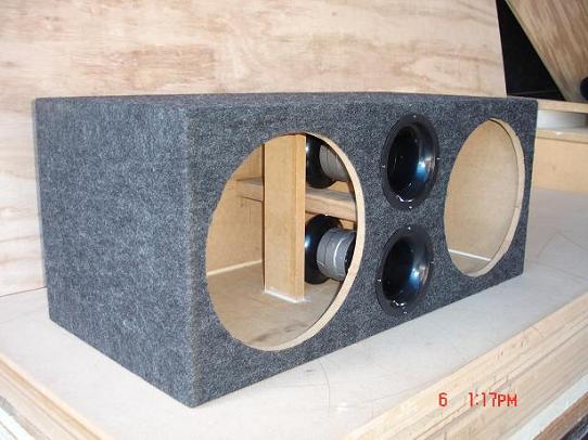

well sometimes (depending on the shape of course) i connect a piece of wood from front baffle just near to the speaker cut out hole to the rear wall
call me nuts but a few times i actaully used a 2x4" piece of wood to stiffen front baffle board (between the 2 subs) to the rear wall .....
Username: Rovin
4 10 Pioneer...
Post Number: 13028
evidence :
Upload ....

yea a slot port box. the port is centerd between the two drivers and the port at the back of the box bends out to both sides to uses the back wall as part of the port as well as the top and bottom of the box.
Username: Mendonmafia
Post Number: 1086
