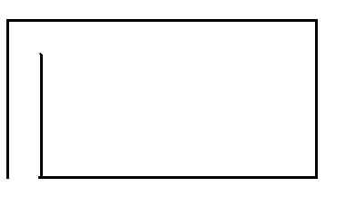

Post Number: 546
would this be slot port?
Los Angeles, CA
Post Number: 17773
i don't think that is a slot port. even though you are using part of the wall of the box as a wall of the port, its not using the whole side.

Username: Surferdude9371
Im BTL Bumpin
Post Number: 548
this one?
Los Angeles, CA
Post Number: 17774
which is the port opening?
Im BTL Bumpin
Post Number: 549
red is opening
Los Angeles, CA
Post Number: 17777
oh ok. i would consider that a slot port then.

thnx trying to calc port lenth

so if its 6.5x20 it would be a slot?
Los Angeles, CA
Post Number: 17790
wow i always thought slot port was when the port is off to the side of the box sharing the wall of the box. you know like a slot. but after doing some research, phil is right. slot port just means a rectangle port.
sorry p.rick, i gave you a misinformation.
