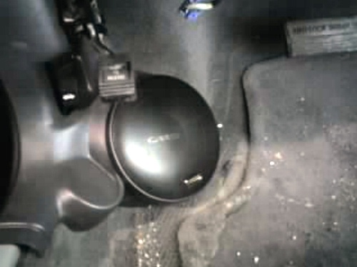

Test fit, things are huge, lOl. The panel on my door for the 5 1/4's I will glass the inside, mount the mid on top of the panel not inside like the factory speaker. this will allow me to build a small enclosure inside, a pocket so to speak and I will use weather strip to seal the door panel to the door effectively sealing it and not exposing my component to the inside of my door.. Polo.
