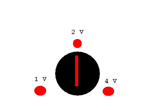

So confused about gains still
Username: Surferdude9371
Im BTL Bumpin
Post Number: 531
i read something i thought that all the way turned clockwise is the lowest and turning it counter clockwise turns it up but that makes no sense pls help
Username: Big_edge_head
Milwaukee, Wisconsin IF IT DOESNT...
Post Number: 1244
Here you go...
http://www.bcae1.com/gaincon2.htm
Im BTL Bumpin
Post Number: 532
so all the way left is more volts than all the way right?
Post Number: 1245
no..... all the way left should be 0. at least every amp ive seen was like that. i think massive audio amps are reverse but im not sure.
Username: Nd4spd18
Northwest PA
Post Number: 5779
On all of my amps left is down (higher voltage) and right is up (lower voltage)
Post Number: 1246
well yea u mean.......like if you had a high HU output voltage it would be to the left. and a lower preout voltage it would be to the right. .
iIt would be more to the right for lower volage from the HU.
and all the more to the left for a higher preout voltage from the HU.
Im gunna start confusing myself. lmao
Im BTL Bumpin
Post Number: 533
like my hu is 2v rms should it b more left or right i have a kx2500.1
Username: Van_man
Boston South, MA
Post Number: 3283
If your HU is 2 volt, turn the gain to the 2 volt making. Match HU volts to amp gains.
Alternativly, Turn the gain all the way down, (Quite). Then turn the HU volume up to the maximum that you will ever turn it up. Like 3/4 or so. Then turn the gain clockwise till you reach the 2 volt mark, or you start to hear distortion. Tweek it back a hair and your set.
Im BTL Bumpin
Post Number: 534
prob is my gain isnt marked in volts just numb 1 to 11
