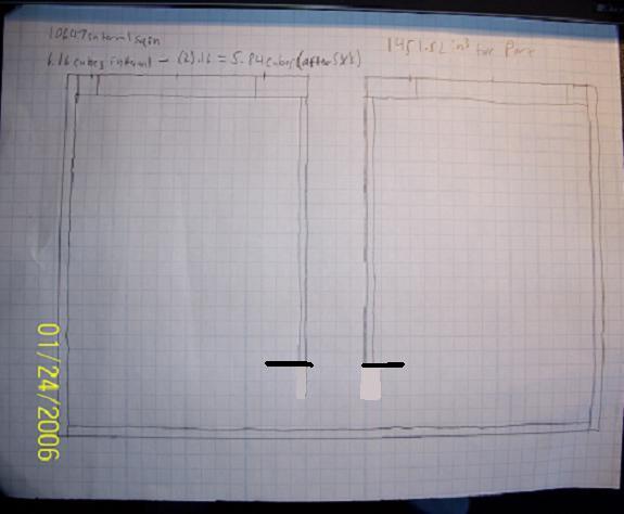

New box plans. make sure this look legit.
Username: Mendonmafia
Post Number: 795
thats my sh1tty drawing of the new box im going to build. subs and port firing forewards into the cabin. its 37.5 wide and 25 deep and 14.5 high.
is it cool if i use half inch mdf to make the port or do i need the 3/4 inch?
also the port is 4x13 in this particular design and there is 2 inches from the back of the box is this ok? since the effective area would be half of the total area for each sub? give me your opinions on this.

That 2" thing at the back is going to f.ck you over I think.
Username: Talon01
Team revolution , Pa Usa
Post Number: 746
if you use a 4" wide port you need a min. of 4" from the back wall

"That 2" thing at the back is going to f.ck you over I think."
You mean the double baffle on the front? I think thats what you meant...its 1.5" and will be perfectly fine.
Username: Naledge503
Http://www.LowDownForu...
Post Number: 2790
^^^nevermind, your talking about the space between the port and the back wall.
Yeah Mark, like scott said, you will need to have a min. of a 4" space from the back wall. Just take 2" off each port wall and turn them in 2"

would 4 inches from the back wall be plenty tho or should i strive for more? i am just going to make the port slightly external to pick up the extra spacing in the back.
do you all think with that vent area (52in) i shouldnt have any vent noise and not lose to much output?

o shoot is .5 inch mdf ok to use for the port walls? or should i deffinately use .75"

distance of port from back wall should be @ least width of the port so if ur port is 6" wide then it should be @ least 6" from back wall .......
Username: Rovin
4 10 Pioneer...
Post Number: 12857
oh & stick with 3\4mdf for ur port walls ......

alright then ill make the external part stick out 3 inches just for good measure. thats a pretty simple fix.
still wondering aobut the .5 inch mdf for the port walls tho. is that ok to use or is it going to be to flimsy?
also still wondering if im going to have problems with 52 incles of port.

An L shape or T shape? it seems like it would be werid if i did L shape.
Post Number: 2793
Like this...

thats not too much area at the openings?

"also still wondering if im going to have problems with 52 incles of port."
watch like I said before youll have no problems with the port at the power your using
Username: Insearchofbass
Post Number: 7610
sean its going into a 2000 Chrysler 300M.
that sub and port arrangement should be good
four inches should be fine ive done the port width rules before and it worked but you can give it more if you want to...give it 6 for good measure it might give you more output
that will be fine and ideally you want a straight port with no turns for the best output so going external a bit fixes your problems
52 inches of port will be fine
go with .75

"that sub and port arrangement should be good"
if your going sub front port front ....I think that will work best then just play around with placement in the car...you can go sub back port back, sub up port up, sub forward port forward, with that arrangement
