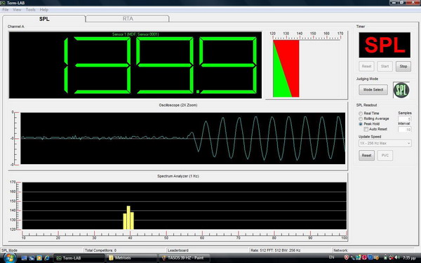

Silver Member Username: PaogrAthensGreece Post Number: 161 Registered: Dec-05 | Yesterday i went to a friend and i metered my car with a termlab. The number is very impressive! 139.9 at 39Hz!! I didn't expect so much! Here is the foto: car: nissan sunny '89 sedan 4D no electric upgrades sub: alpine typer 1222d box: 2cf at 32Hz amp: sinus sla 1500 (1500w - 1ohm) HU: alpine 9812rb engine on at 2000rpm, doors windows closed, sensor on the dash |

Gold Member Username: Nd4spd18Northwest PA Post Number: 5620 Registered: Jul-06 | That's good SPL for a 12" sub........ my 15" only did .6 db more than that when it was only 1000w. Of course the vehicle has something to do with it. |
Gold Member Username: InsearchofbassPost Number: 7598 Registered: Jun-04 | NICE score at 39 hz |
Platinum Member Username: Rovin4 10 Pioneer... Post Number: 12851 Registered: Jul-05 | wow ! Thats VERY impressive for a SQL sub tuned that low whne i had my 2 each was in about 1.75cuft also tuned 32hz & it used really shake stuff around outside my ride ...yes even after a yr i still miss em.... |
Silver Member Username: SomedonniedudeIllinois United States Post Number: 774 Registered: May-07 | Thats pretty sweet. How much power do you think you were running to it when it hit 139.9? |
Silver Member Username: PaogrAthensGreece Post Number: 162 Registered: Dec-05 | To tell you the truth i don't know. I have set the gain as this link says: http://www.subwoofertools.com/forum/setgain.asp with volume 25/35 and sub out 10/15. With these settings i was playing a soundstream T5-15. One day while i was listening to a bass song (Gimmie That (Produced By Drumma Boy)) i turned the volume at 30/35 and after a minute i smell something from the sub and i turned the volume down. So i beleive that the amp puts the max clean power with volume 25/35 and sub out at 10/15 (when i have it at 1ohm). Now with the typer i had the volume at 25/35, sub out 8/15 and i played a sweep 100 to 20Hz to see where it puts out the max db. It hit 139.1 at 39Hz. Then i played a 39Hz tone and it hit 139.6. After that i set the sub out at 12/15. Result: 139.8 Then volume 28/35 sub out 15/15 and it hit the best result 139.9. At the end i turned the volume all the way up at 35/35 but it didn't give me better number.. I think i was running thes sub with over 1kw. What do you think? *LPF was at 160Hz and subsonic at 25-26Hz, voltage 12.6-12.7v |
