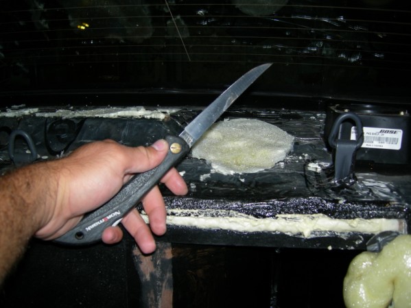

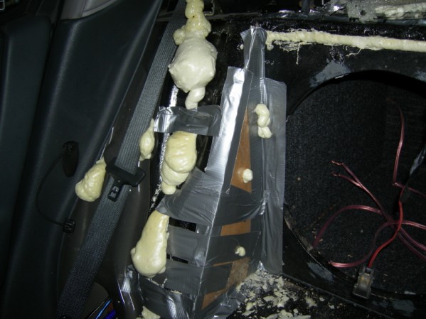

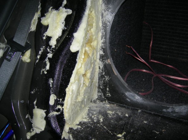

Gold Member Username: Safe_crackerChicago, IL US Post Number: 3881 Registered: Jan-06 | http://s237.photobucket.com/albums/ff98/Master_Safe_Cracker/?start=60 That stuff is awesome! When you are happy with the final shape be sure to hit it with a brushing of resin then paint it black to keep from discoloring. I used a razor sharp filet knife to trim and if you notice I even filled the 6x9 holes.Use cardboard with a layer of 3m tape to keep from sticking. Don't worry about the former leakng to much as you just need a general shape. polo.. |

Platinum Member Username: WingmanaliveA pic is worth 1000 posts!! Post Number: 12331 Registered: Jun-06 | So much for the resale value of that car lol. Also, nice pic of the murder weapon. I like great stuff, but it's a permanent item ya know? Also, how do you keep the sh1t from clogging the tube when you don't use the whole can at one time? ![]() |

Gold Member Username: Safe_crackerChicago, IL US Post Number: 3884 Registered: Jan-06 | You don't, one shot deal! As far as permanant it can be removed! If you notice I painted the the metal with the bedliner, this is a natural adhesion promoter and if need be it can be scraped up and to remove the greatstuff just use a torch. First you need to use a digrinder with a 3" wire brush attacement. This has actually increased the value on my vehicle, I have saved all the interior panels, it would all go back together nicely.. Polo.. |
