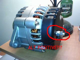

so i should go from the alt + to this stock fuse box? and keep the fuse in there?
http://s237.photobucket.com/albums/ff269/volfenhagking1600/?action=view&current= 0109081543.jpg
http://s237.photobucket.com/albums/ff269/volfenhagking1600/?action=view&current= 0109081543a.jpg

Keep your stock wiring like that but for the upgraded wiring just run it from the alt to the battery.

That is your alt + terminal. Just run a wire from there to battery +

you can keep the stock wireing or get rid of it. i took mine out because it was worn and i didnt need it creating any shorts. i would ground the alt case where you mount it to the engine right to the batt - and then in your pic the + terminal right to the batt+ then have a peice of wire from the chasis to your batt-
i rewired my fuse box on my car and got rid of the other stock grounds and got rid of the stock alt wire to fuse box. also i didnt fuse my + wire to the alt.
