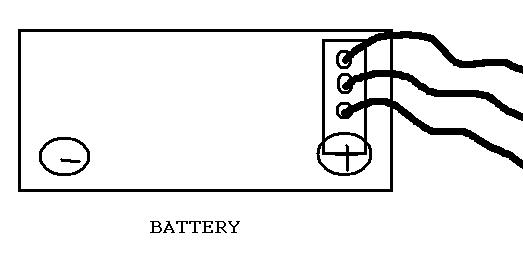

Platinum Member Username: BestmankindIM THE REAL SLIM SHADY Post Number: 16437 Registered: Oct-05 | anyone know where i can order one? i know i can probably go to home depot and look for one but i am sure some site has one already pre-made for a car battery. here is a pic of what i am talking about. ![]() |
Silver Member Username: BoomtankRochester, NY USA Post Number: 460 Registered: Oct-06 | Do you mean to link multiple batteries together? |
Platinum Member Username: BestmankindIM THE REAL SLIM SHADY Post Number: 16438 Registered: Oct-05 | no. its just i have so much sh!t going in to the battery terminal. i want to spread them out a bit. it will also look cleaner. lol. so one hole will go to the battery terminal and the other holes will be used to connect everything to it. |

Gold Member Username: camBC Canada Post Number: 1486 Registered: Nov-06 | Just make one. Or replace the bolt that tightens the terminal you have now. Then you can get nuts and washers and connect stuff using ring terminals. |

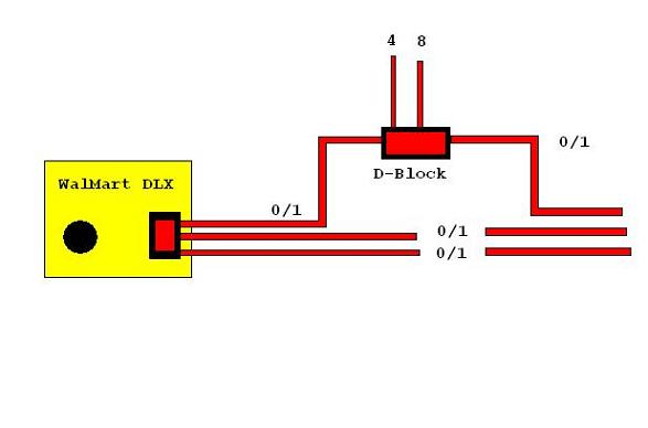

Platinum Member Username: BestmankindIM THE REAL SLIM SHADY Post Number: 16439 Registered: Oct-05 | it would look something like this. ![]() |
Platinum Member Username: BestmankindIM THE REAL SLIM SHADY Post Number: 16440 Registered: Oct-05 | cam if i can't find one that is premade then i guess i'll make one. to give you a run down, here is a list of cables that are connected to the positive terminal on the battery. 1 8 gauge cable 3 0 gauge cables 1 4 gauge cable |
Silver Member Username: Talon0112 audioque 2.5 145.2 ..., Pa Usa Post Number: 589 Registered: Jun-07 | they do make them i am trying to remember where i saw them, dbdrag uses them all the time |
Gold Member Username: Naledge503Http://www.LowDownForu...Zac Davis 4 ... Post Number: 2555 Registered: Jun-06 | Bus Bars? |
Gold Member Username: Van_manBoston South, MA Post Number: 3217 Registered: Mar-06 | This will take care of the 3 0/1, Then maybe a D-block 0/1 in/out, and terminals for the 8 and 4? http://cgi.ebay.com/KnuKonceptz-Triple-1-0-Gauge-Battery-Terminal-Pair-NEW_W0QQi temZ220186740852QQihZ012QQcategoryZ50549QQssPageNameZWDVWQQrdZ1QQcmdZViewItem |
Platinum Member Username: BestmankindIM THE REAL SLIM SHADY Post Number: 16441 Registered: Oct-05 | last year when i went to competitions, alot of the competitors do it. that is where i got the idea. i was just wondering if some car audio website already has premade thats all. i don't feel like driling holes on the copper bars myself. don't have the bits for it. |
Platinum Member Username: BestmankindIM THE REAL SLIM SHADY Post Number: 16442 Registered: Oct-05 | mark that is awesome but i don't have a side post on my battery so where would i put the other ones. lol. yeah jessie, bus bar. |
Gold Member Username: Van_manBoston South, MA Post Number: 3218 Registered: Mar-06 | ![]() |
Platinum Member Username: BestmankindIM THE REAL SLIM SHADY Post Number: 16444 Registered: Oct-05 | oh yeah. i forgot all about distro blocks. damn. hahahaha. thanks marc. you are the best. |
