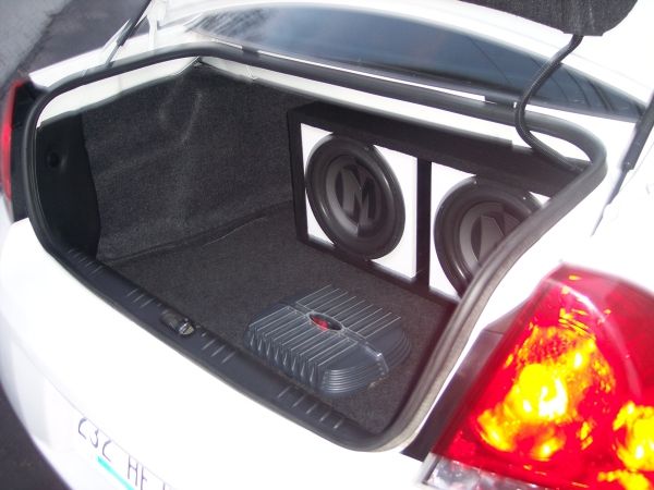

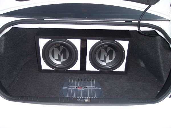

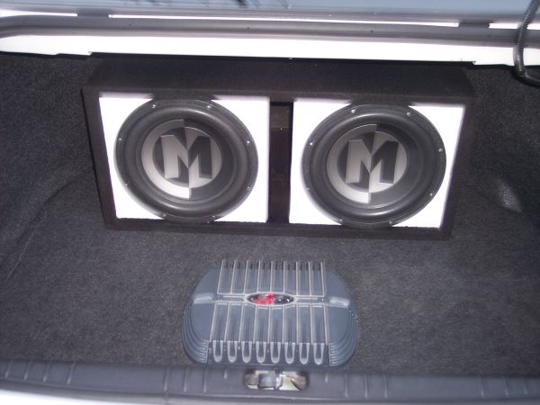

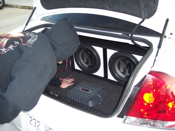

The pictures below are from an install that me and my partners(team blakbocs) did in an 06 impala. We are based in western ky and make custom enclosures, install anything, detail, etc.. anyways let me get back on subject.
2 memphis 15-PR12D4 250wrms
RF 550s 275wrms X 2 @ 2ohm
Box= 4cuft @ 35hz, black carpet, white vinyl faces
stock head unit,line out converter,JL audio 7volt line driver
running the wires...

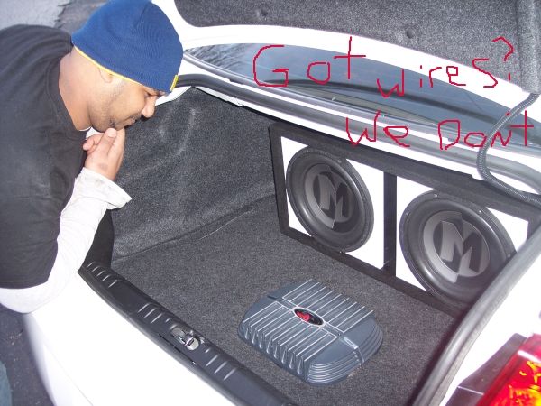

customer checking it out
mad mikes cousin

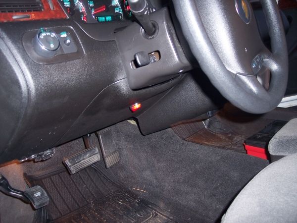

the kill switch

ha no wires,i bet ya ppl are like wtf,has car audio gone wireless

Looks clean. How do they sound?
Are those similar to the Memphis M-class subs because those used to be really cheap and had very strong sq.
Username: Mmaudioconcepts
Murray, KY USA
Post Number: 338
Registered: Jan-07
they sound dam* good for the price,. they hit everything pretty well. So id give SQ on a scale of 1-10 a 7. This car came with stock sound deadener but it still has great output in the cabin is would say low 140s.(there is sound deadener between cabin and trunk. I am used to bass but the driver isnt and he says he gets head aches and cant breathe. I think they handle more power than the Mclass series but the Mclass does have a little bit better SQ.

140's eh? Hey what is that little square thing in the middle of your trunk? Polo..

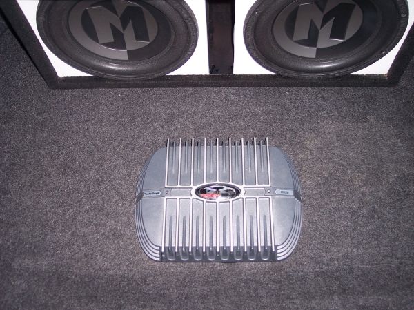

that amp is so small lol

ctmike, when i put that on my profile it was a stunt to draw attention to my product but then i realized that it was a disrespectful move on my behalf, i really cant say that my product is better because i dont know if it is, but i can tell you that my product gets the job done well, we take pride in our work, and if you are not satisfied we will work with you until you are. I can say that all of the above box builders mentioned are great and all have their strengths and i just have my own set of strengths.
colby, one of my partners is a chemist and we make our own substance to line the box with. this substance eliminates standing waves, and increases output. we also do basic things that everyone an do like no 90degree angles in the interior, etc,
yes that amp is small, though it is underrated slightly,

i like that install. looks clean. but wouldn't it be better to mount the amp somewhere else so you can use the rest of the trunk space? that amp ain't that big so i am sure you can find a better place.

the guy wanted the amp there. the trunk has huge spaces on the sides. he wanted it there because that amp lights up the trunk at night along with a neon that is mounted above the sub box.
