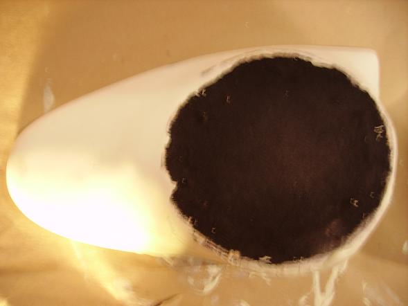

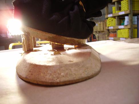

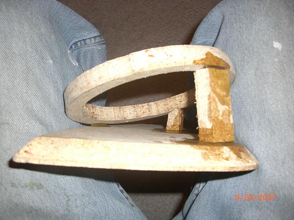

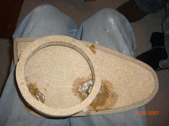

basic frame
side shots
with felt added
(I read in CA&E to put the wood circle on top of the speaker ring to hold the felt on after it has been stretched across... It worked good)
Panels with first coat of resin
Gonna do some more work on them later today after Christmas with the family.

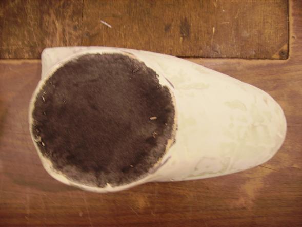

I got the fiberglass sanded and the first coat of body filler put on tonight. I need one more coat of body filler for the low spots and then I will 80 and 180 it and it will be ready for primer. Should have the primer on them tomorrow.

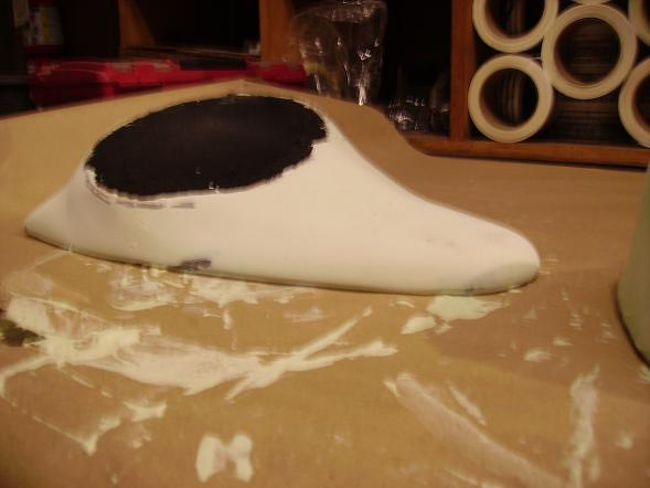

I applied the body filler last niight and sanded it tonight. Ready for primer (hopefully tomorrow)
Before sanding
After sanding

Yeah, Im defiantly taking my time. Seeing as I am painting it, ANY improfection will show as soon as the clear coat hits it...
