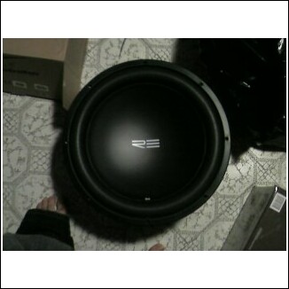

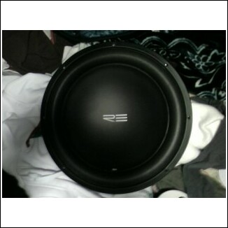

my digital camera ran out of batteries so i had to use my cell

Looks good man. let us know how you like it.
Username: Nyyfan13
Fi SSD USA
Post Number: 7701
Looking good Ray.
-apem
Post Number: 16215
nice sub.
