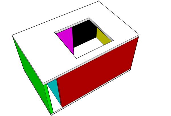

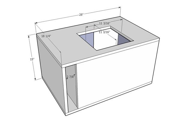

heres what i have so far:
ill upload more pics of the box finished or if you have sketchup by google ill just give you the skp file

The box is:
2.5cuft, tuned 34hz
28 wide x 15 tall x 18.25 deep
Hope you like it!
