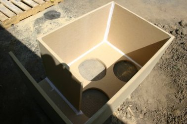

i accually drew a picture with that first post but it was too big to post and i was at work so i didn't have time to resize.
Username: Boomtank
Rochester, NY USA
Post Number: 438

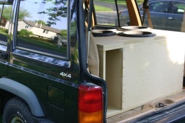

will that leave enough room between my tailgate and the port? i know there has to be some room and i'm sure theres like a foot but i just wanna make sure... and then do i need to brace that or anything?

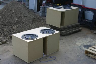

what did your box for the 3 12s look like maybe ill just do 12s instead, post a pic if ya got one thanks man!!!
Username: Boomtank
Rochester, NY USA
Post Number: 439
my 12 box was the same setum bux more airspace. 7.5cu^ft tuned to 36Hz
Username: Boomtank
Rochester, NY USA
Post Number: 440
Username: Frkkevin
Post Number: 4288
nice box.. but not so very nice cutouts :P
i'd go 3^3ft after displacement tuned to 35hz with 48 square inches of port

Username: Boomtank
Rochester, NY USA
Post Number: 441
yeah lol i did it with a dull jigsaw blade. Now i use a router and a 3 fluke spirial upcut. Much easier.
