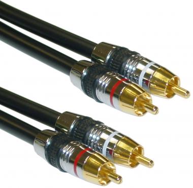

Gold Member Username: The_image_dynamicSan Diego Post Number: 3174 Registered: Dec-06 | RCA Cables ![]() |
Gold Member Username: Tatonka-[Team Audib... Post Number: 1102 Registered: Mar-07 | RCA Cables send a signal (like your music) from the headunit to your amp to make the music play and go boom boom. |
