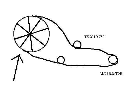

as some of you may know, i am getting sort of a whine in the morning. it goes away after a few minutes of drving. but its bothering the hell out of me.
anyways this morning i opened the hood and check to see where the sound was coming from. here is a picture to briefly illustrate. now remember there are some stuff missing in the picture but its just to give you an idea.
the sound seems to be coming from the area of the big wheel. what the hell is that wheel called?
also the belt that goes around the alt and stuff is called the seraphim belt?

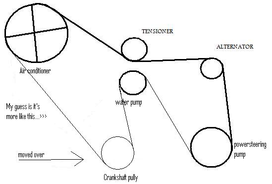

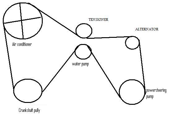

looks like the "big wheel" in your drawing is the crank shaft pulley.
their should be another belt attached to the crankshaft pulley for the water pump and power steering.

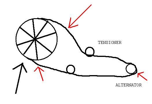

Thats a very nice offer chad. But if Im included, Just make a donation to the Ronald McDonald house (or Other charity of you choosing) for me instead. But thanks for the offer.
And re-reading your post, I found the problem. Your belt is loose.. I high-lighted in red areas of concern...

The picture doesn't really help unless you can tell us what the "big wheel" is, but it could be many things and would have to see it to diagnose the problem. Where are you located?

sinful sys. the big wheel is the crankshaft pulley, it couldnt be many things because chad has all of the things running off that belt in that picture and the only thing it could be is the crankshaft pulley because the belt has to turn.

yeah the picture is crappy but i just put two and two together, something has to turn the alt and the crank pulley is bigger then the alt pulley so...yeah. anyway i also think its weird that it was coming from the crank but i dont think it really was coming from their theres to many other things in that area that are more prone to failure.
-apem
Post Number: 15917
here is a better pic. lol.
sometimes the squeaking came from around the alt and sometimes by the big wheel. its gone now. thank god.

Mat Dope said "his pic goes from his alt to two tensors to his crankshaft pulley"
Wrong again, why would there be two tensioners (not "tensors", which is an arithmatic term) when only one is needed. If there were two then I doubt the belt is or would be slipping and squeaking. Just want to clear that up so people aren't confused.

The crank might be slightly lower as well.
Username: Sinful_systems70
15 INCH WANG...
Post Number: 984
That might be moved over too far but I basically think it will to the right of your design a bit.

Marc said..."Probably slipping on the Alt pully. When you start your car, the alt tries to recharge the battery, so it causes strain on the belts."
Now "Probably slipping on the Alt pully." is 100% correct (besides the spelling "pulley")
but
"When you start your car, the alt tries to recharge the battery, so it causes strain on the belts."
-- not necessarily, before you start the car none of the pulleys are in motion so when you start the car, the initial jolt of the crank pulley starting to spin is faster than the old belt could grab and speed up the other pulleys causing rubber on metal to slip creating a squealing sound. At the time of startup, the crank pulley could spin inside the belt struggling for grip as well.

"Mat Dope said "his pic goes from his alt to two tensors to his crankshaft pulley"
Wrong again, why would there be two tensioners (not "tensors", which is an arithmatic term) when only one is needed. If there were two then I doubt the belt is or would be slipping and squeaking. Just want to clear that up so people aren't confused."
would like to add that there is a possibility for three pulleys that are not driving something and they are called: Roller tensioner, a Dynamic tensioner roller, Stabiliser roller. Haven't seen this much but I have before and I had slipped my mind for a bit. Sorry for my mistake, I was wrong, but they are both not tensioners im sure, Thats all I am saying.
