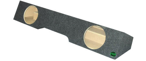

Silver Member Username: Phil_salisburyPost Number: 412 Registered: Sep-06 | Michael, It' not impossible to put 2 subs ported under the seat of silverado: This a box with 2 JL 10w3V2's ported and what you can't see in the pic is between the subs is an amp tray covered with a trim panel. ![]() |

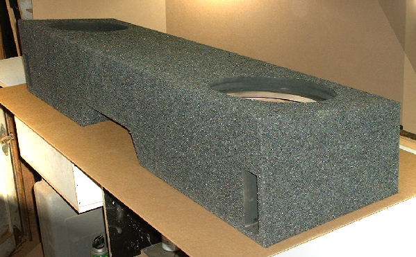

Silver Member Username: Mike_16Reedsburg, Wisconsin Us Post Number: 748 Registered: Aug-06 | ok ui understand now. ok now this box is probably what my friend mike woudld luv. and im gon atalk him into buyign this box just liek this oen from you. and hed luv how the amp rack is uilt into teh box. nice job btw. wel im gona ask you how muc hdo u charge for this box to be built and shipped to the zip cod eof 53848? |
Platinum Member Username: Rovin4 10 Pioneer... Post Number: 12549 Registered: Jul-05 | Phil - man that box looks damn sweet ....![]() |
Silver Member Username: Phil_salisburyPost Number: 414 Registered: Sep-06 | Michael, Keep in mind this enclosure is designed to be used with the JL subs I mentioned, ya can't just throw any subs into this enclosure and expect to sound/perform as it did for the JL's. The design of the enclosure pictured will not support the recommended spec's for the Kickers CVx's, so, your friend is going to have to ditch the kickers and get the JL's 2 JL 10w3V2's. Or Go with another subwoofer that will fit within the design limitations of the enclosure per the spec's already establish for the design and more important, subs that will fit. Cost $ 235.00 As for shipping, can't quote ya that because the zip code ain't coming up as a valid zip code. |

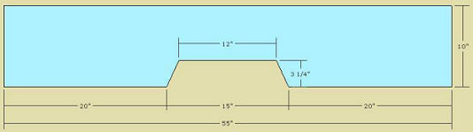

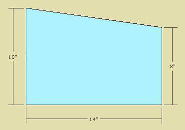

Silver Member Username: Phil_salisburyPost Number: 419 Registered: Sep-06 | Jesus Christ, ok, here it is in a nutshell. The graphic's shown are of the full dimensions I have for under the seat of a silverado and I should of been more specific as to what model year it was, in this instance a ( 2004 Silverado Extended Cab ). OK, the box you put up there is a completely different type of enclosure specific to the 2000 Silverado and oddly enough I have been back and forth with another customer with a 98-99 Silverado. So, as it has already said by MS & CT Mike, the only d@mn way anything is going to get sorted out is for the EXACT dimensions/measurements for the area under the seats to be known first. Then and ONLY then will I know what can or cannot be done in terms of: Volume available given what the design dimensions bear out. What and if the subwoofer will or will not fit and if a different subwoofer will have to be used. Type of enclosure - sealed or ported. I'm sorry if I'm being alittle testy, but, I am trying along with everyone else telling you that what your friend would like vs what is going to work is the cold hard reality that " YOU CAN'T ALWAYS GET WHAT YOU WANT ". I have been down this road so many times, it's not even funny, I know that a customer has there heart set on a setup and I try like he!! to do my best to make a design work to give that customer what they want, but, sometimes I also have to end up telling that customer what they want just ain't going to fly. One last thing and I'll shut up. I have heard systems of all kinds and the one's I have heard with low RMS wattage ( 500 & under ) that sounded and hit pretty d@mn hard and loud. While, that may not impress anyone outside of your friend, your friend has to take into consideration that for what he has to work with for what he can do is all that going to happen and no more. I can think of at least 6 different setups, sub/enclosure wise that would work for this, but, there are folks here that would laugh there azz off and tell me to GTFO here, but, I know for a fact they would hit hard, tight and be decently loud. |
