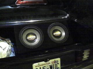

New member Username: Genuinemonarch91Tacoma, Washington Post Number: 1 Registered: Nov-07 | hey. I bought these subs from my friend, his sister took them out of her car because she wanted space in the trunk. I tried to find information on them but i couldn't really find anything because they're old. I was wondering what kind of amp to get. ![]() |
New member Username: Genuinemonarch91Tacoma, Washington Post Number: 2 Registered: Nov-07 | I forgot to say, they are Kicker CVRs? thats what it says on the speaker. |
Gold Member Username: RideredderCornell, IL USA Post Number: 1099 Registered: Sep-05 | What kind of amp did they have running them? Those are 12's right? If I remember correctly, those subs are 250wrms a piece SVC 4ohm. Get an amp that does 500wrms at 2ohms, unless someone else says different. |
Silver Member Username: NorthomahaPost Number: 591 Registered: Mar-06 | assuming that these subs are dual 4 ohm which is probably what they are, could be dual 2 ohm, either way you need to pull them out to take a look and find out for sure what impedance they are (ohms) should say on the sticker on the back of the magnet. anyway if they are dual 4 ohm heres two options Cheap Option http://www.onlinecarstereo.com/CarAudio/ProductDetail.aspx?ProductID=16337 Good Option http://www.onlinecarstereo.com/CarAudio/ProductDetail.aspx?ProductID=16918 let us know what voice coil configuration they have and we'll be able to tell you for sure! good luck |
Silver Member Username: NorthomahaPost Number: 592 Registered: Mar-06 | my fault, i confused them with the new cvr's dont know about the old ones |
Gold Member Username: RideredderCornell, IL USA Post Number: 1100 Registered: Sep-05 | Well, now I'm confused. I found these on eBay and they say 400wrms a piece DVC 4ohm. http://cgi.ebay.com/2-KICKER-COMP-VR-12-CVR12-Subwoofers_W0QQitemZ170168830769QQ ihZ007QQcategoryZ18803QQssPageNameZWDVWQQrdZ1QQcmdZViewItem But yeah, your best bet would to take them out of the box and look to see what the voice coil configuration and such is, then we can recommend an amp to go with them. |
Gold Member Username: 420alldaylongPost Number: 2916 Registered: Sep-06 | The kicker CVR's come in Dual 2ohm or Dual 4ohm. All kicker CVR's subs New/old are. 8" 200RMS 400PEAK 10" 400RMS 800PEAK 12" 400RMS 800PEAK 15" 500RMS 1000PEAK |
