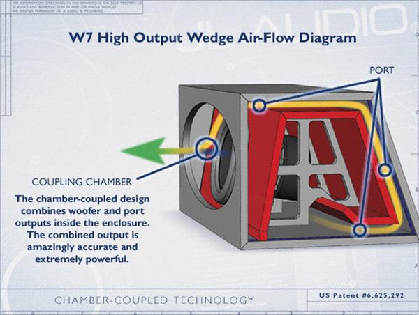

The best thing to do is, get a plan/layout of the HO box design and build it there (if no one can ship it there). It's not a magical box. I'm sure somebody must have it. No point in paying hundreds of dollars for something that's worth $30 in materials.
Username: Phil_salisbury
Post Number: 384
Good Luck trying to find the plans for a JL HO enclosure. The only way anyone is going to be able to provide any type of design/plans for that specific enclosure is if someone already owns one and is willing to take a saw to it to cut it in half to see/measure the actual details.
I doubt anyone would be willing to carve up a HO box just to scam the design details for what the cost is for one of those enclosure's.

Yeah, I got to see and HO box up close but wasn't able to take a really good look at the guts of it.
From what I could tell, the port does nothing more than use the entire id width of the enclosure by whatever height and starts in the bottom part and goes up the back and across the top and terminates in that front recessed cavity area where the subwoofer is.
It's almost like there using the front portion to create a resnoance chamber to re-enforce the bass response/output given the area of the cutout on the front.
I would most likely be a royal b!tch to take one of those apart just to geta look see at the guts of it, one things for certain, it would never go back together
Username: Naledge503
Http://com4.runboard.c...
Post Number: 2194
Post Number: 386
Yeah, I already saw that graphic.
If I had the time, money, equipment and facility's to build and test enclosure's in between trying to make a living designing and building enclosure's for customers, I'd be rich man.
