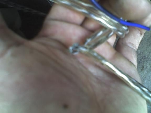

bout 8ft of RCA's bundled up
Rca's spliced in NOT 1 but 2 places! Not just splice, but the + and - were twisted together on each side(like speaker wire)...oh and why bother using electrical tape?
Not only did the guy that originally did this fry the owners HU, but he tested the install w/ his HU and smoked it too...

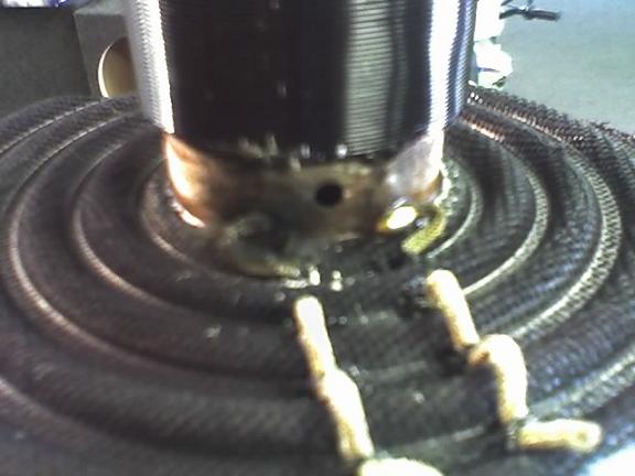

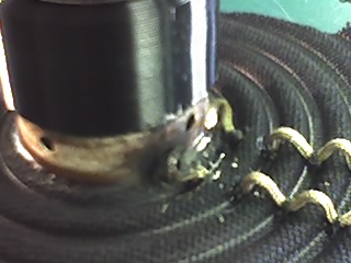

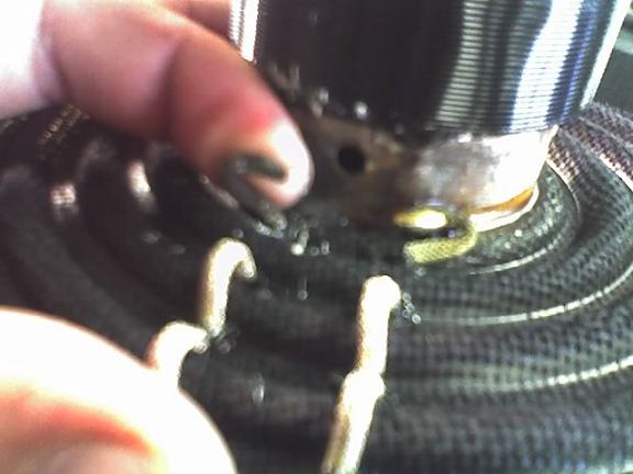

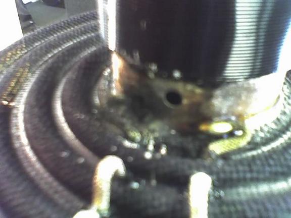

Some genius bought a pair of MTX 5512's, prebuilt box and a TA5601 (600wrms @2ohm).
He shows up the next day saying, "the subs were loud at first, but last night the amp started messing up!...You sold me some BS man, I now how to install...my boy showed me, he said this stuff blew cause its cheap". I go out to see his install (if you can call it that). Open the trunk, I can already smell em.
EVERY knob on the amp was pegged to the right....LPF, Gain, BB, Light Effects...lol...all of em.
I show him what went wrong, tell him its his fault and we shouldn't warranty the subs/amp but will this time. I take everything in...both subs are gone but the amp is good (amazingly).
Here is what the VC's looked like:
The tensil leads EXPLODED! (w/ a 600w amp)

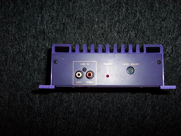

A guy came in awhile back and his HU's wasn't playing. We tested the HU and the internal amp was fried (speaker output) but the RCA's still worked.
There was an old Jensen 55wmax amp in the back of the shop, so one of the guys there gave it too him. (This guy comes in from time to time) They told the guy to just use the amp....to hide it the the dash or something, what way you can at least have your front door speakers. (as we had no use for the lil Jensen)
The guy comes back in alil while later w/ this "stealth" install:
Username: Frkkevin
Post Number: 4020
wow that is a tiny amp :-)
Username: Frkkevin
Post Number: 4021
.. just noticed the Audio/Video cord.. lol :-)

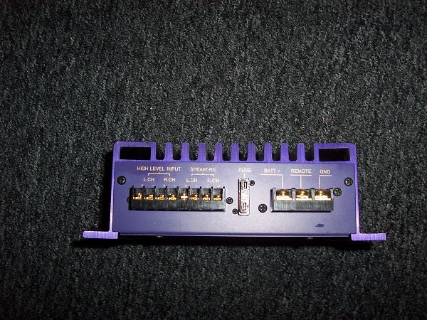

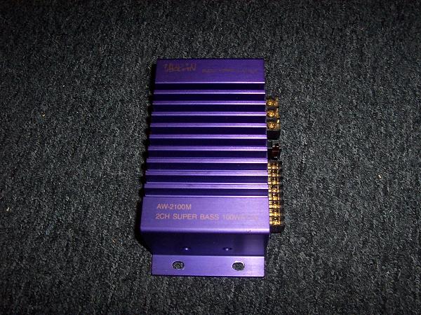

Post Number: 10932
You call that a small amp lol?
I dug up awhile ago something I had from years ago. An Urban audioworks 100w 2ch amp. As far as I know still works. This was the cheap stuff back in my day lol. I think it was $20 brand new 15 years ago.
Realistically it's 100w total max. 50rms, 25 per channel. Call it a tweeter amp lol?

my friend had one of them along time ago except it was the 2 channel one that was 100 rms per channel,wasnt nothang special.

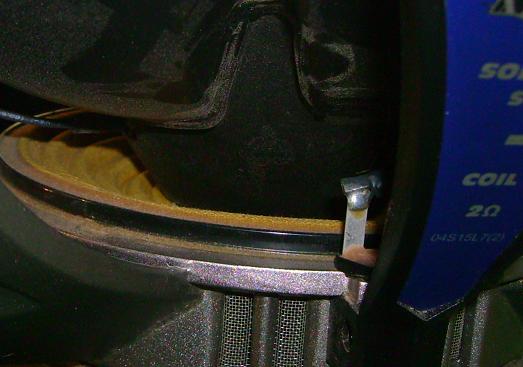

Well guys...I have yet another one!
This one came in today around 4:30.
Its an L7 15"...and sadly, I see ALOT of Solo's like this.
I don't know if its just the spiders on Solo's tend to do this or what, but prolly 20% of the solo's that show up at the shop are like this. (Well, not this bad...but close)
Well...here are the pics:
Its worse in person. This is the worst sagging suspension I have ever seen in person.
Just sitting there w/ no weight on the cone, its litterally bottomed out! Coils are fine though.
I hardly ever see any other subs that wear out like this. Being that I see so many Solo's like this...I'm going label this "Solo Sag Syndrome".

Username: Nd4spd18
Northwest PA
Post Number: 3730
"Solo Sag Syndrome" LMAO
L7s quality blows big time
