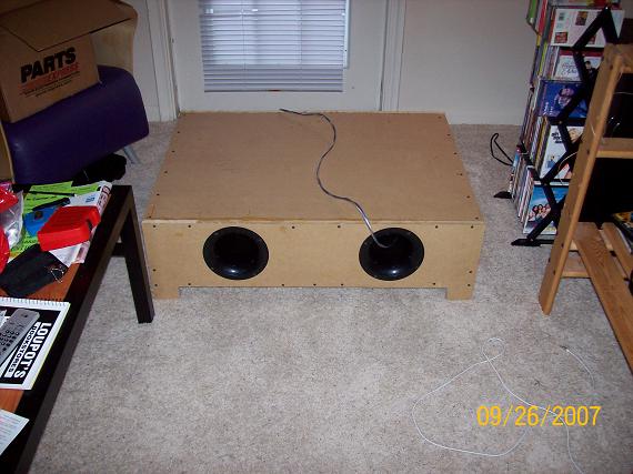

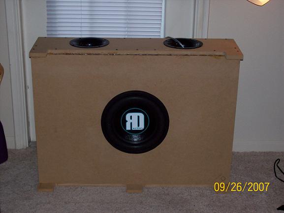

Username: Jtown
ATX, Texas
Post Number: 580
here is my down firing 3 cubes, single 12"
