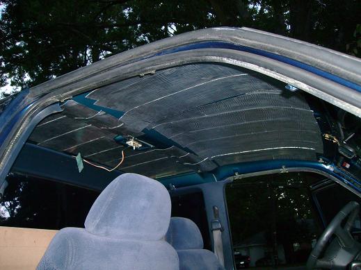

Monday, October 15, 2007 - 00:58 GMT Well, I finally got around to deadening my roof today. I ended up running out of Peel-n-Seal, but I got alot done. Cleaned the roof off w/ acetone. The first layer. It was kinda cool today and I didnt have a heat gun, so used a hair dryer. Just heated it up until it had some shine to it and rolled it on. Got 3 layers on the back half of the roof, started on the second layer on the front half and ran out. I'm going to do a total of 4 layers in the places that flex bad and 3 in the places w/ less flex. More pics and results (by ear) tomorrow!

Monday, October 15, 2007 - 01:31 GMT Like Kevin said, its in the roofing section. I bout the last 2 rolls Lowes in Monroe had. Going to check at Home Depot for more tomorrow. I got it for ~$14 for a 6"x25' roll. Not hard to install, just takes time.

Monday, October 15, 2007 - 01:35 GMT did you used all the peel and seal?? like all all that you used on you roof on your pics all the 2 rolls in there???
Username: Tremor1127 Fi
Post Number: 2349 Registered: Aug-06
Monday, October 15, 2007 - 02:11 GMT my guess is the last pic was two complete rolls.
