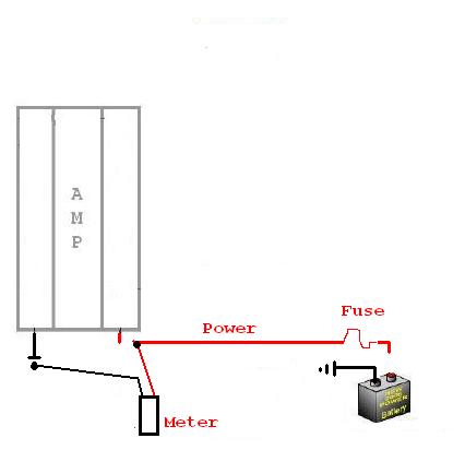

| Gold MemberUsername: Van_man Boston South, MA Post Number: 2929 Registered: Mar-06 | where is this fuse locater? on the amp? near the amp? near the battery? Do you have a dmm, or any meter?disconnect the power wire at the amp, and at the battery. put the meter on it and test if there is continuity between power and ground.there should be none. That fuse may not be up to the job either. bypass  it after you verify there is no short and see if amp stays on. If it does, put a better(higher quality ) fuse on the power wire near the battery.  |

| Silver MemberUsername: cam Post Number: 804 Registered: Nov-06 | Don't bypass the fuse. That's asking to burn your car to the ground. It sort of sounds like you have a worn spot in the insulation, and that's touching the chassis every now and then. I'd use the DMM to check for shorts, and if you get no continuity, go over your whole power wire looking for holes in the insulation. |
| Gold MemberUsername: Nd4spd18 Northwest PA Post Number: 3312 Registered: Jul-06 | If the fuse keeps blowing, either your power wire is shoted to ground somewhere or your amp is damaged and shorted internally. Disconnect the power wire from the amp and try another fuse. If it still blows, you need to trace your entire power wire and find the short. The most common place is at the firewall, since a lot of dumbass people run wire though a hole with sharp edges and no padding around the wire. |
