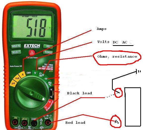

Gold Member Username: Snarl2004Audioque 12 SD2.5s, Earthquake P... Post Number: 1728 Registered: Dec-06 | I know what setting to use on the dmm to check the resistence but what do i hook it up to? the power wire and ground on the amp...? my ground for my amp is about 16" long mabey shorter "Also are the grounds under the hood ample?" not quite sure what you mean by that |
Gold Member Username: Van_manBoston South, MA Post Number: 2918 Registered: Mar-06 | Set the meter to read ohms. put one lead to the ground wire at the amp, and the other lead to a bare metal ground. It should read close to zero. Make sure you disconnect the ground wire from amp first, Did you use 0/1 from bat neg to chassis? and alt to bat? and engine to chassis? And Beyma makes some crazy high current amps. Dont know the model... its 3000 wrms i think. google it. |
Silver Member Username: Big_edge_headMilwaukee, Wisconsin USA Post Number: 654 Registered: Mar-07 | a good ground is .3-.4ohms or lower. anything higher and you should find a diff point. |
Gold Member Username: Snarl2004Audioque 12 SD2.5s, Earthquake P... Post Number: 1729 Registered: Dec-06 | "Did you use 0/1 from bat neg to chassis? and alt to bat? and engine to chassis? " ya its hard to find a point to ground to but tomarrow ill check the resistnce and see what it says. does it matter which wire i touch to bare metal and which one to the wire. And any piticular spot i should touch the dmm to for the bare metal? |
Silver Member Username: Big_edge_headMilwaukee, Wisconsin USA Post Number: 655 Registered: Mar-07 | the pos(red) should go to the grounding point and the neg. the chassis |
