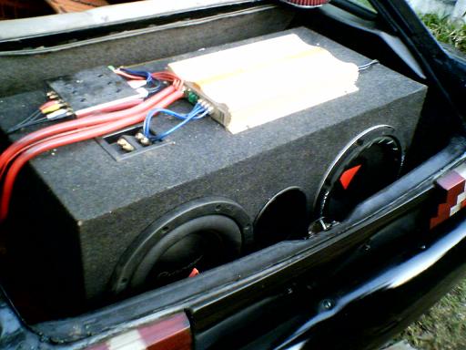

New member Username: BazzviperPost Number: 1 Registered: Oct-07 | i have put a starsound svc and a pioneer dvc in the same box running of the same 3000 watt audiobank class d mono block does any one think i sould keep the subs the same and why the way i have wired it up it is running at 1 ohm |

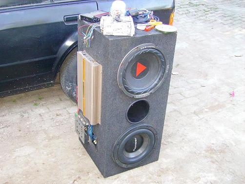

New member Username: BazzviperPost Number: 2 Registered: Oct-07 | this is my sound system![]() |

Gold Member Username: MgbcsLincoln, Nebraska Post Number: 1620 Registered: Dec-06 | That's a bad idea man...don't use two different subs |
New member Username: BazzviperPost Number: 4 Registered: Oct-07 | shot man but they damn well worked like hell |
Silver Member Username: Talon0112 audioque 2.5 144.8 ..., Pa Usa Post Number: 149 Registered: Jun-07 | your actually running 1.3ohms and you shouldnt run 2 diff subs |
Silver Member Username: Talon0112 audioque 2.5 144.8 ..., Pa Usa Post Number: 150 Registered: Jun-07 | if there 4 ohm ers |
Gold Member Username: InsearchofbassPost Number: 6616 Registered: Jun-04 | Make sure your amp is one ohm stable bridged if your going to do it otherwise you will fry your amp. As far as two different subs its not recommended because of sound issues but it can work. Also as I look at your picture I see your box is all one chamber based on the single large port. So youll have to run two subs. |
Gold Member Username: MgbcsLincoln, Nebraska Post Number: 1621 Registered: Dec-06 | I was referring to the differing ohm-loads rather than the actual sub mattering... |
Gold Member Username: InsearchofbassPost Number: 6617 Registered: Jun-04 | actually its 1 ohm or 4 ohm if they are dual 4 ohms each http://www.rockfordfosgate.com/rftech/woofer_wizard.asp?submitted=true&woofer_qt y=2&woofer_imp=4 |
New member Username: BazzviperPost Number: 5 Registered: Oct-07 | its 1 ohm trust me and the amp runs 1ohm stable and they r 4ohm subs one svc starsound 4ohm and one pioneer dvc 4ohm per coil the starsound has a larger voice coil its a 3" and the pioneer is a 2,5" |
Gold Member Username: InsearchofbassPost Number: 6618 Registered: Jun-04 | thats cool Ben you were actually right ideally if you were talking about the subs but like I said it can work |
Gold Member Username: InsearchofbassPost Number: 6619 Registered: Jun-04 | actually Scott is right I missed it was a dual 4 and a single 4 .....it equals a 1.34 ohm load http://www.rockfordfosgate.com/rftech/woofer_wizard.asp?submitted=true&woofer_qt y=3&woofer_imp=1 |
