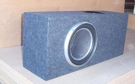

do u mean something like this p2 12Rf i did for a guy recently ....
Username: Frkkevin
Post Number: 3627
kind of.. except the port goes through the rear deck of the car and into the cabin
