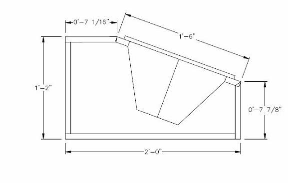

Silver Member Username: Bayrent88Ingleside, Texas USA Post Number: 114 Registered: Jul-06 | well the box is a wedge so its kinda hard to explain dimensions but the box is going into a ford mustang i found a port calculator online but i need a fequency to tun the box to...how many Hertz should i tune to.... |
Silver Member Username: Bayrent88Ingleside, Texas USA Post Number: 115 Registered: Jul-06 |
Silver Member Username: Bayrent88Ingleside, Texas USA Post Number: 116 Registered: Jul-06 | well that didn't work | |
Silver Member Username: Bayrent88Ingleside, Texas USA Post Number: 117 Registered: Jul-06 |
Silver Member Username: Bayrent88Ingleside, Texas USA Post Number: 118 Registered: Jul-06 | well yall should be able to read that one if you have adobe reader | |

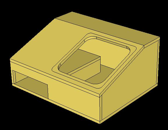

Platinum Member Username: WingmanaliveA pic is worth 1000 posts!! Post Number: 10361 Registered: Jun-06 | Here ya go...... ![]() |
Silver Member Username: Bayrent88Ingleside, Texas USA Post Number: 119 Registered: Jul-06 | thanks....how did you do that | |
Platinum Member Username: WingmanaliveA pic is worth 1000 posts!! Post Number: 10368 Registered: Jun-06 | ![]() |
Silver Member Username: Bayrent88Ingleside, Texas USA Post Number: 120 Registered: Jul-06 | well...theres what i got designed....so what should i tune it to....?????? | |

Silver Member Username: Phil_salisburyPost Number: 316 Registered: Sep-06 | John, Whats the width of the box for this design and don't forget to say whether there ID or OD, I'll be able to tell you the volume of the enclosure based on the dimensions ya post. |
Silver Member Username: Bayrent88Ingleside, Texas USA Post Number: 123 Registered: Jul-06 | the box is 30"wide.....outside to outside...thanks for the help Phil | |
Silver Member Username: Bayrent88Ingleside, Texas USA Post Number: 124 Registered: Jul-06 | i get 4.65 cu ft give or take a little thats without the speaker or the port displacement |
Silver Member Username: Phil_salisburyPost Number: 318 Registered: Sep-06 | Josh, The enclosure's TOTAL volume is 3.84 cu.ft. before any displacements. The side surface area subtracting for 3/4" Material total is 233.0984 sq.in x 28.5" ( ID Width ) = 6643.3044 cu.in. ÷ 1728 = 3.84 cu.ft. |

Silver Member Username: Phil_salisburyPost Number: 322 Registered: Sep-06 | Josh, Here's your box. simplest approach would be to move the sub to one side and put the port as shown. Port Size - 4 x 10 x 19 1/2" ![]() |
Silver Member Username: Bayrent88Ingleside, Texas USA Post Number: 126 Registered: Jul-06 | sweet....so the port would be alright facing the rear of the car....oh and what program did you use to make that...just curious | |
Silver Member Username: Phil_salisburyPost Number: 323 Registered: Sep-06 | Yeah, the port is fine firing back like that, unless the port is going to be obstructed by something. I use Sketch Up to draft the design of the enclosure and I used BBP 6 to calculate the spec's of the design. |

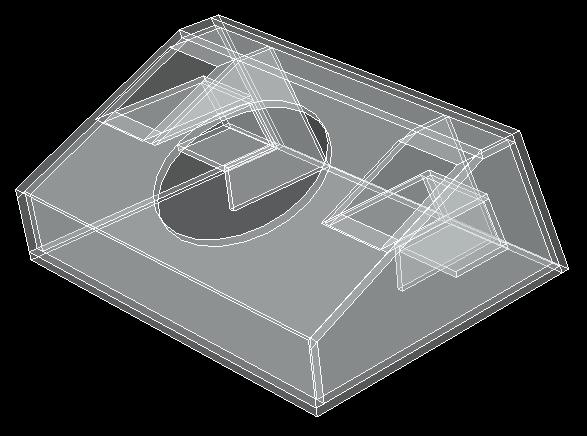

Silver Member Username: Phil_salisburyPost Number: 324 Registered: Sep-06 | BTW, here's a design I did for a Fi 15 BTL ported for a Stang. ![]() |
Silver Member Username: Phil_salisburyPost Number: 325 Registered: Sep-06 | Ray, Thanks on both. |

Silver Member Username: Bayrent88Ingleside, Texas USA Post Number: 128 Registered: Jul-06 | what year was the mustang that design was for.....how many cu ft is the box...would it work for my L7...would you be will to give me ur designs for it... | |

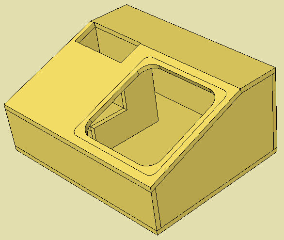

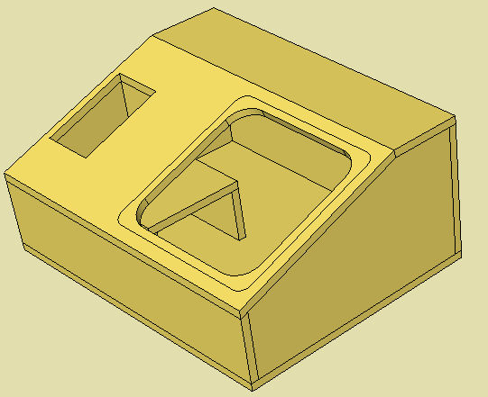

Silver Member Username: Phil_salisburyPost Number: 326 Registered: Sep-06 | Josh, To be honest, I don't remember the year stang that enclosure was designed for, but, I do know that the designed is based off an existing design I did for a 2002 Ford Mustang GT - Dims - 31" x 10 1/2" x 23 1/4" and then the design what modified to fit the owners stang @ 34"w x 14"h x 27"d. As for the first design with port firing back. Here are two other designs with the port firing up: This one has the port still at 4 x 10 x 19 1/2. This one, the port is 5 x 8 x 18 11/16 ![]() |
Silver Member Username: Bayrent88Ingleside, Texas USA Post Number: 129 Registered: Jul-06 | 4 inchs wide...that kinda big...but i am sure you know a hole lot more than me on this stuff so i think i am gonna go with it.....oh thank for all you help Phil...you one hell of a guy...what is the box tuned to | |
Silver Member Username: Phil_salisburyPost Number: 327 Registered: Sep-06 | Port Tuning falls in around 38Hz. As for the port itself, keep in mind that kicker spec's state the port area for 3 cu.ft. @ 2.5" x 16.25" or 40 5/8" sq.in., so, 4 x 10 = 40 sq.in. of port area is on the mark. Sweating that 5/8 isn't going to squat one way or the other. |

Silver Member Username: Bayrent88Ingleside, Texas USA Post Number: 132 Registered: Jul-06 | the 2d draiwing is mine....i used autoCAD to make that one | |
