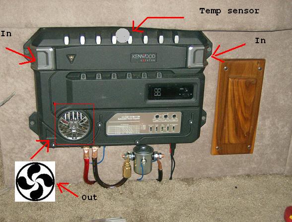

Gold Member Username: Van_manBoston South, MA Post Number: 2907 Registered: Mar-06 | Just to add, I picked one of these up today and wired it into the fans power, and it sits on the amps heatsink at the top. Its set for 125 degrees. Now my fan only runs when needed. ![]() |

Silver Member Username: JtownATX, Texas Post Number: 443 Registered: Mar-07 | what is that? |
Gold Member Username: Van_manBoston South, MA Post Number: 2909 Registered: Mar-06 | its a thermal switch. Theres a metal disk inside that flexes at a certain temp. The one I got "makes" at 125 degrees. That means when it senses 125 degrees it opens the circuit, turning on the fan, and turns off the fan when temp drops below 125. Now my fan only runs when the temp is high. You can get them in diffrent temps that connect when the temp is made, or disconnect when the temp is made, the later being the kind that send amps into protect when themal overload sets in. Also my amp has vents and a fan inside. I mounted my fan so it pulls thru the existing fan, like a turbo boast. ![]() |
