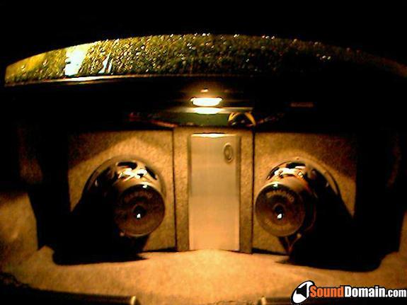

Gold Member Username: Nyyfan13Fi SSD USA Post Number: 6176 Registered: Jul-06 | im assuming you mean inverted mounting of the subs....having the basket and magnet on the outside? that correct? if thats the case, it wont effect sound. wont make it louder or cleaner. it will change the volume of the box. this an example of what i think your talking about ![]() |

Silver Member Username: Santa_fePost Number: 181 Registered: Jul-07 | yeah thats what im talking about.....so if the box was bandpass do i want the subs facing the pleix glass and the magnets in the part of the box with the ports right? |

Platinum Member Username: WingmanaliveA pic is worth 1000 posts!! Post Number: 10174 Registered: Jun-06 | Yanks is right. Aside from the bling factor it's basically only a displacement issue when designing the box. Short of that....... If you need a source here's one from someone who just might know a few things lol...... http://www.glasswolf.net/caraudio/inverted.html |

Gold Member Username: SouthernrebelMonroe, Louisiana 2 DD3515s, 1... Post Number: 5271 Registered: Mar-04 | The only difference in mounting subs inverted vs normal is the net air space of the box will be alil different. Ex: 1.5cuft net box, ~38hz tuning, 2"x10" port 23.5" long....sub w/ .2cuft displacment mounted normally. Take that exact same box and mount the sub inverted and you will have: 1.7cuft net, ~35.7hz tuning...exact same port ![]() |
