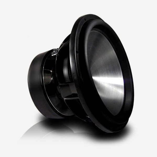

I have an 18" Eclipse TI Pro, its 3000 watts rms quad voice coil at 1 ohm, i dont need something to power it to full potential but, i would prefer it to be close to 3000 rms. i will buy two smaller amps if i have too. That way i dont have to upgrade in amps later on. I am currently looking at an orion 2500d and a 2400 kinetik battery for around $600 canadian (US and CND are at par). Is that a good deal? please send me links or let me know about other amps. thanks

shoot man if you want to pushing anything over like 1000 watts Rms your going to want a high output alternator, also with the extra battery it would kill you stock stuff in minutes, for what you want you really need a high outpuut alternator, google irragi alternators, or excessive amperage. if i were you i would go with two smaller amps each pushing half, looki into phoneix gold amps, i think them some that can do what your looking for, this will be costly

IA40.1 a lot better than the orion, but its exspensive used they go around $800, the orion will work but the ti pro can take a lot more power than that amps gives out.

quad 1 wires to one ohm final load cal. its just like two dual 1 ohm.

Santa Fe, why do I see in alot of posts you act like you know what you are talking about, and then you say something completely false. I do agree, about 1300+ (considering the stock alt is at least 105amps) is all that can be run properly with an extra battery and big3. Hooking up an extra battery will not kill your "stock stuff" in minutes. In fact, I know several people that run extra batteries, and it helps them alot, including me.
Chris, you will need a HO alt if you are planning on running that much power, and also an extra battery to go along with it. You will also need to do big 3. That orion deal is a pretty decent deal if it's legit. That sub can take over that though, so I guess its just how much money you want to spend, and how loud you want.

but seriously the memphis is a great amp but dont get it unless u know how to set it up cause they are sensitive amps as im told. you could also look into a autotek 4000.1 those are good amps or as stated before the ia40.1 if you want a serious amp but get ur electrical system setup first try to get a 300 amp alt the big 3 setup then worry about batteries and then a amp you'll be happy you did this after the fact trust me

That rockford should be pushing around 4k at 1 ohm. They are extremely under rated. I have a rockford 4k and birthsheet says 5013. So I would say the rockford would be plenty of power, very nice amp!

Very nice sub btw! I have the little brother 15" ti (not a pro)
