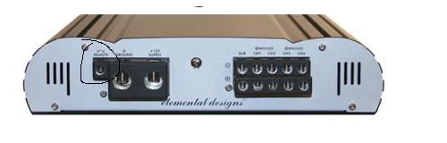

here's a pic of the end of a nine.5...to kinda show you the remote wire hookup

woops forgot the picUpload

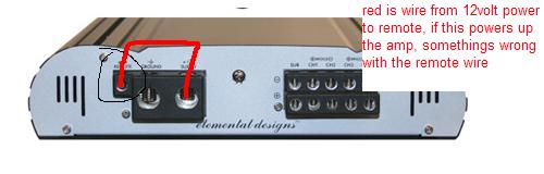

btw, just to make doubly sure its the amp, and not something on the remote wire, disconnect the remote wire from the amp, then use a short piece of wire and run it from the +in on the amp to the rem (should be almost side by side anyway. IF the amp comes on then....somethings messed up withe the way you wired the remote

Thank you very much i tried connecting it to the 12 V and it's working so it's the rem wire the thing is is that the Rem wire is giving power to the amp i guess just not enough because we tested the rem wire not sure of the name of it but you connect one end to the ground the other to the power lights up if their is power... that works so im guessing it's not getting enough power so my next question is is what exactly do i connect the rem wire to? i just put in with a wire off the back of my head unit that had power while the car was on...
