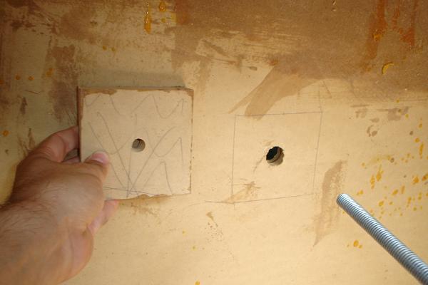

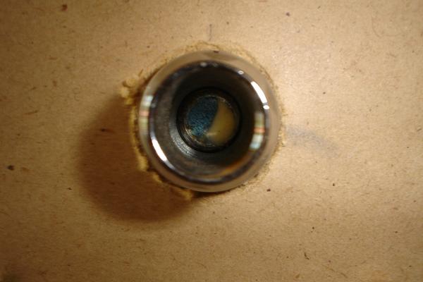

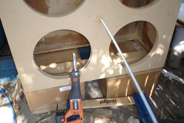

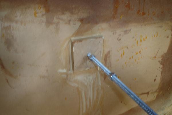

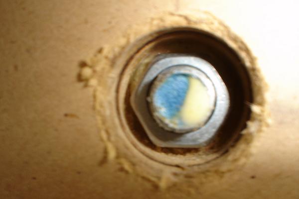

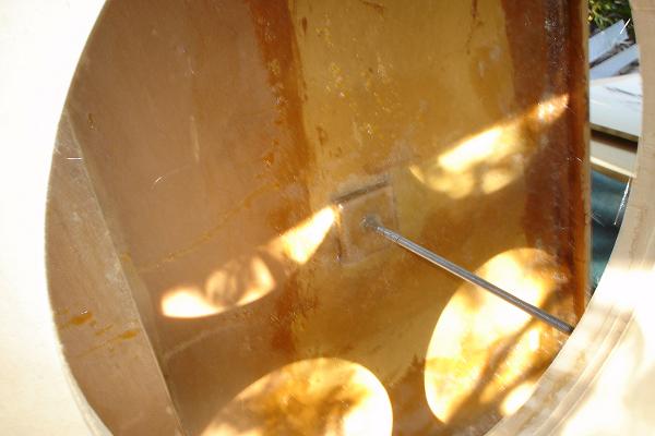

Silver Member Username: TejcurrentPost Number: 348 Registered: Apr-07 | Okay, I drilled a 1/2 inch hole for the 1/2" rod on the top side, and used a hole cutting bit like you would find in a door-knob installation kit for the bottom (which is exactly where I got mine from since I do that kind of work sometimes.) I took the small square from an earlier post and drilled a 1/2" hole in the center- marking where it needs to be on the inside. The bit I was talking about- it's just big enough to fit a socket into without taking a whole lot of wood out. I fed the rod through from the inside and put the nut on the end where I wanted it to be. Then put the socket on to center it up with the hole. Okay, the board is then glued Finished product on the bottom You can see it's nice and smooth so it will sit flat on the floor of the vehicle. Put a couple finish nails in there, but the rod has enough tension alone to hold it in place till the glue dries. (it doesn't really need screwed because there's no real force against it, and it will easily hold whatever flexing the baffle tries to do.) Just wanted to take a picture of this socket set I got a few months back. It has no back to it and can easily go over any size bolt it needs to, or spark plugs ect, ect. Found at Lowes. |
Silver Member Username: TejcurrentPost Number: 349 Registered: Apr-07 | Bolt secured. Ready to cut to size- battery powered sawzaw ftmfw Again, real short work of that. And a final coat of fiberglass. I didn't get many pics of that because I used a lot of hardener so it would dry quicker. As humid as it was the other day it took sooo long to dry, I really don't want to wait for that again. If not tonight tomarrow I'll carpet it and put the terminal bolts on the back. Then comes the amp rack. |

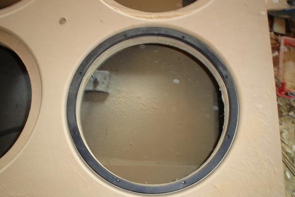

Silver Member Username: TejcurrentPost Number: 390 Registered: Apr-07 | I have a finish layer I'm putting on top and making into part of the amp rack. I'm rounding that over with a 3/4 round over bit for cosmetic reasons- the extra layer is really just for aesthetics. |
Silver Member Username: YukhuiMyrtle Beach, South Carolina USA Post Number: 647 Registered: Jan-06 | Oh aight, sounds good to me. |

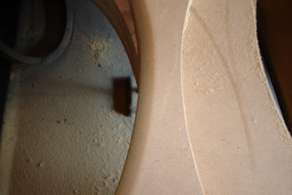

Silver Member Username: TejcurrentPost Number: 396 Registered: Apr-07 | Some of the cut-outs, they're starting to stack up 3rd face layer, I'm sure it'll add some (however little) additional bracing, but its more of a trim plate to make it look a bit nicer and hide the rod sticking up, and it will be part of the amp rack- pics of that tonight hopefully.. Test fitting a gasket to check fit, about 1/8 inch all around. Pretty basic stuff with the round-over. Test fit a sub just to make sure things were looking good- fits perfect. Okay, completely rounded over. I believe its time to carpet it, screw in some terminals (I'm using bolts) and slap it in. Once it's in I'll be building the amp rack based on where it sits in the vehicle. |
Silver Member Username: YukhuiMyrtle Beach, South Carolina USA Post Number: 648 Registered: Jan-06 | What are you using to screw the subs in? |
Silver Member Username: TejcurrentPost Number: 398 Registered: Apr-07 | specialty screws. |
Silver Member Username: YukhuiMyrtle Beach, South Carolina USA Post Number: 649 Registered: Jan-06 | got a link or pic? |

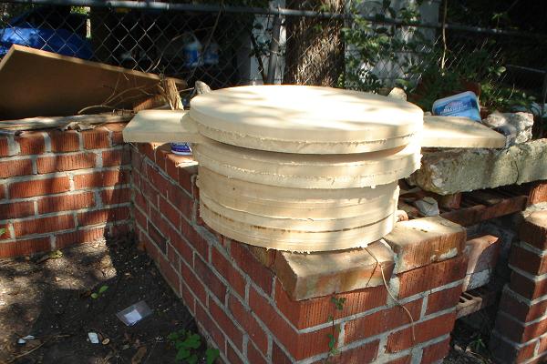

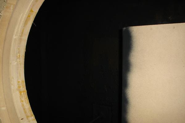

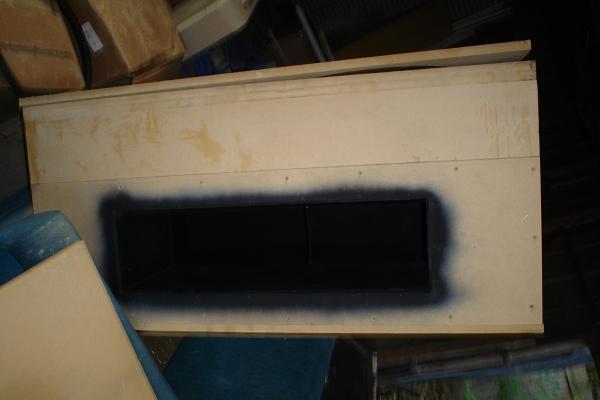

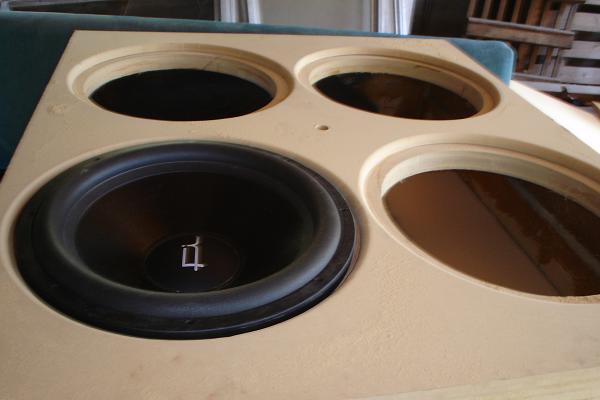

Silver Member Username: TejcurrentPost Number: 502 Registered: Apr-07 | [URL=http://s116.photobucket.com/albums/o7/alpinemayn/?action=view¤t=MOV01476.f lv][IMG]http://i116.photobucket.com/albums/o7/alpinemayn/th_MOV01476.jpg[/IMG][/URL] There's two btl 18s |
Silver Member Username: TejcurrentPost Number: 503 Registered: Apr-07 | http://s116.photobucket.com/albums/o7/alpinemayn/?action=view¤t=DSCN0162.f lv Playing with test tones for a short bit. http://s116.photobucket.com/albums/o7/alpinemayn/?action=view¤t=DSCN0165.f lv There's the door moving- all the windows down all the way. |
Silver Member Username: TejcurrentPost Number: 504 Registered: Apr-07 | Here's a vid parked in front of a shop- don't know how well that showed up, but the shop door was moving in and out, and those panes were flexing pretty bad. http://s116.photobucket.com/albums/o7/alpinemayn/?action=view¤t=DSCN0166.f lv |
