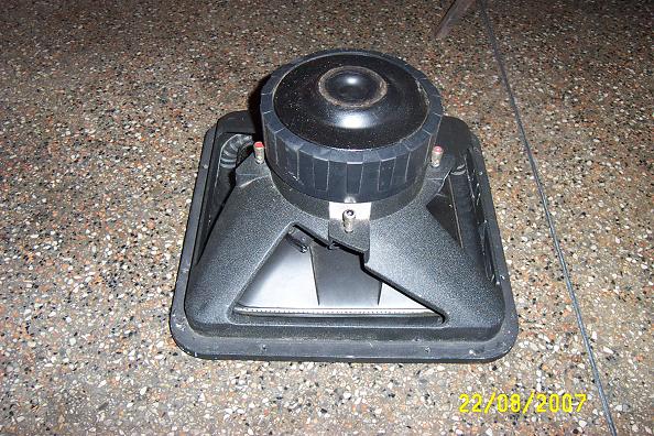

u all ever box build for any kicker 15L7
looks like this model
cant find much info online like its xmax & sub displacement
dont want to make d box overly big because the guy's car its going into .the trunk opening is not big at all so i estimate the sides can be 16.5 x 16.5 & max length i can work with is 38-40" preferably 38"
hoping to tune it 36hz for SQL - ideas any1 ??? .....

thats for this particular model ?
sub displacement & xmax ???
...dunno if im not seeing it but all im seeing is the newer silver cone model

What year is that?^^^^^^^^^^^^^^^^^^^^^^^
Username: Rovin
4 10 Pioneer...
Post Number: 12013
thats what i been trying to figure since i am no follower of kicker subs
looks like this though this
camera batt just died so i didnt get to take pix of the cone but it looks like
Username: Rovin
4 10 Pioneer...
Post Number: 12014
Upload ....
Username: 420alldaylong
Post Number: 2526
That last picture looks like the 2002 models. If am right there manual is on there site.

yes it does seem its the 2002 model & i found its xmax but no sub displacement figure .....
