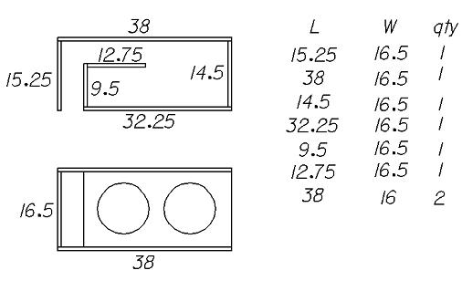

Wednesday, August 01, 2007 - 17:43 GMT Can you design me a sub enclosure for 2 12's that are in a single chamber the box should be around 3.5 cuft and ported tuned to around 38hz max: Height=18 Width=16 Length=38 also can you post the diagram up here

Wednesday, August 01, 2007 - 18:07 GMT 3.5 cubes 38hz 80 sqinches

Wednesday, August 01, 2007 - 18:14 GMT did you account for subwoofer displacement? if not the port tune will change some (higher tune) as well as the airspace (lowering)

Wednesday, August 01, 2007 - 18:17 GMT lol this guy.... sean this isnt the first box plans i have designed.... its 3.5 net 3.75 gross my way of accounting for it 1 10 = .125 1 12 = .175 1 15 = .250 please do not insult me again sean

Wednesday, August 01, 2007 - 20:59 GMT 2.25 net 32 hz 48 sqinches

Wednesday, August 01, 2007 - 21:44 GMT for you Malik 4 cubes 40hz 75 sqinches
