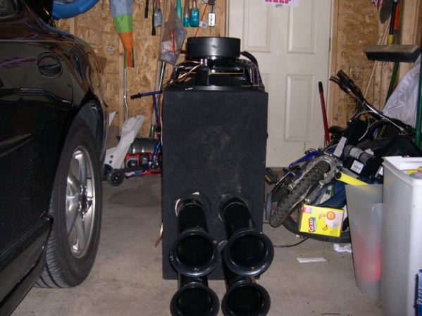

The don't have to be 4" from the side walls just the back wall by the entrance of the port! O have two of my ports that have the rims trimmed to allow it to get clsoer to the wall.. Polo. :-)
