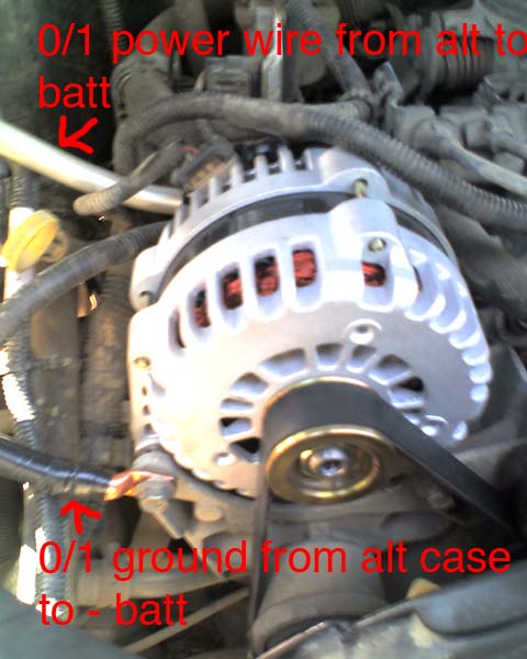

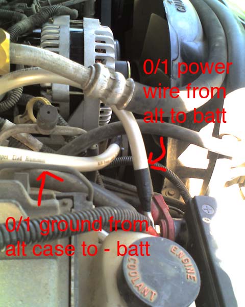

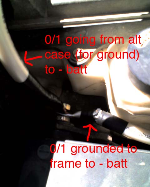

TWiZTiD i no u wanted to see it so here it is...
pretty self explanitory i think.

the most time consuming part of the big 3 was cutting all the 0/1 gauge to length and crimping wire terminals to the ends...and finding a spot to ground it
pretty ez overall

For the engine ground, is it better go engine block -> battery or engine block -> chassis?

Hmmmm, those look like closed-end braze terminals, which means they should have been soldered on instead of crimped. Polo..

Far from being rich and has nothing to do with using the wrong connectors for a particular job. I merely stated that you should have soldered them on which you could still do by heating with a propane torch while wicking in rosin core solder until it drips out of the eye loop. I didn't mean to be a critic just want to help prevent future problems that could arrise from such a decision, sorry... Polo.. :-)

twiztid i bought 10 ft of wire. I had enough for all the big 3 and the ground on my amp. Im getting 15-20 more ft for the power wire for my amp and to wire up my second batt when i get it.
polo wut do u mean they are closed end?
jayem it doesnt matter cuz i grounded that battery to the frame so it would be a waste of wire if i grounded it also to the frame. If the batt is groiunded to the frame and the alt is grounded to the batt then by elimination its alt to frame sorta...u get the point
BTW it is a Iraggi Amputator series 220/175 idle
