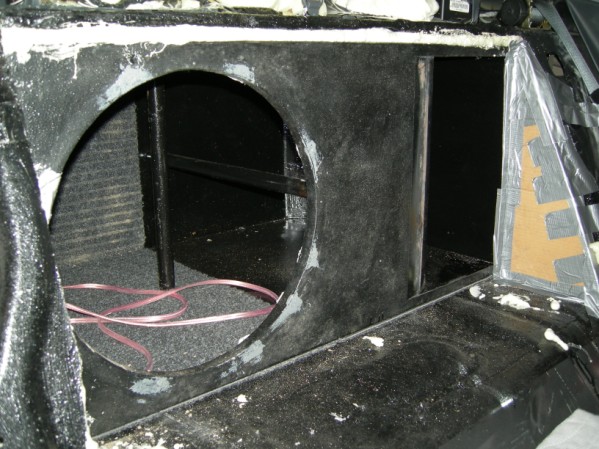

The card board you see to the right is a former made out of cardboard and 3M tape. As soon as the expanding foam is cured it will peel away with ease leaving a nicely shaped side edge. Expanding foam is a great way to shape things but you need a former to retain it and also be sure to coat it with paint or something afterwards. I was going to go with a box with interchangeable ports but for that you usually use a square port and honestly there is more turbulance doing that because your not using the curvature of the sidewall to form the port. For this I picked a frequency right in the middle, added dampening material/bracing so it will play just about anything decently. I am getting tired of switching sh!t up, plus I am 35 and I need to finalize things. If I get tired of this setup I will just sell the car with everything, lmfao.. :-O Polo..

the way i plan on using the drop in ports it will still pretty much be using the back wall, just double up, the port will hug the wall tightly, i will probally use some sheets of sound proofing for a easy seal to.

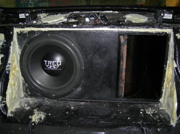

Chad, actually it sounds amazing. there isn't much left of the back seats so you lose maybe 1-2 dbs but daily it is great! http://www.youtube.com/watch?v=1J_GT6XIisc
You can see here how the backseats are and they remove in like 2 mins with a 12V impact drill that I keep in the back. I used 5" L brackets a total of 6 to keep it in place plus a sh!t load of expanding foam. There is so much dampening material around the box there will never be wood on metal. If you look under the box you can see a thin layer of dampening material (1/4") actually epoxied underneith, 4" of foam on left/righ sides plus 1" of foam on top. The back deck was super sprayed with foam and now it is maybe 5 times stronger than before, that foam is tough as hell! I will be using small amounts of it in the doors to create small enclosures for the new comps. Polo.

i want to do mine like that but the problem is i don't the know if the bass will get through the aluminum backing on my rear seat.

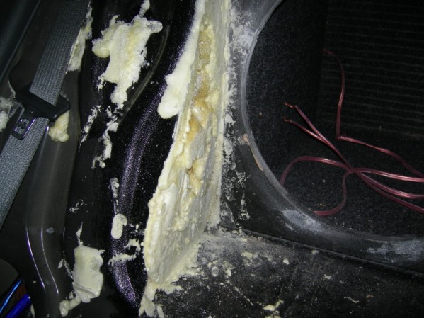

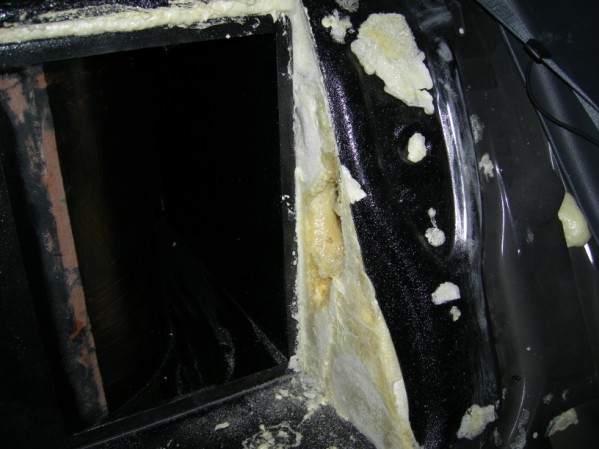

I'm not lazyyy, well not Asian lazy anyways, lol. I poured the foam into the formers notice the pressure behind it some of the duct tape snapped and the formers have bulged. Bulging is better than not having enough because this stuff is very trimable. Notice how the stuff was bursting through the 6x9 holes on the deck, cut it off with a sharpass fillet knife I had. Watch out Wolfy, your sword ain't gonna help you against this pig sticker... hahahhaha.. Polo..

Approx 4cf with port displacement. SawZall was my bestfriend, as you can see, lol. Polo..

Mo-pics! As you can see the foam has formed there are a few holes in it but not that deep, normal for expanding foam to have voids when it cures fast, I will just fill it in. Started to sand a little too. I put the sub in to get a small in car taste, dudes you would not believe!! I played that song by Timberland "The way I are" and it just thumps, plain and simple THUMPS... There is no rattles, it is on partial power using one SX1250 @.5 ohm BUT the gain is only at .5 volt and everything is FLAT. Yes you read right .5v that is almost ZERO, LOL. I thought there was something wrong, so I switched amps and set it the same and ya, same thing. It seems my efficiency went wayyy up but i will bump it at work tomorrow and see. Polo..
