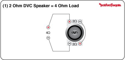

Gold Member Username: The_image_dynamicSan Diego Post Number: 2333 Registered: Dec-06 | From what you decribed you have it wired as shown below (series) which is the correct way for that Alpine amp because it puts out 300RMS @ 4 ohms or 600RMS @ 2 ohms but it is not 1 ohm stable which the sub would be if it were wired in parallel: Verify that the subwoofer is ok using a 9 volt battery and test each coil individually to make sure that something didn't break loose when you dropped it or possibly one of the tinsel leads got snapped. |
Silver Member Username: Night_mirageAmman, Jordan DDs dealer i... Post Number: 661 Registered: Jan-06 | i wired it just like this / But it does n't work Yes DVC . 2 ohm HOW CAN I TEST MY VOICE COILS ?? |
