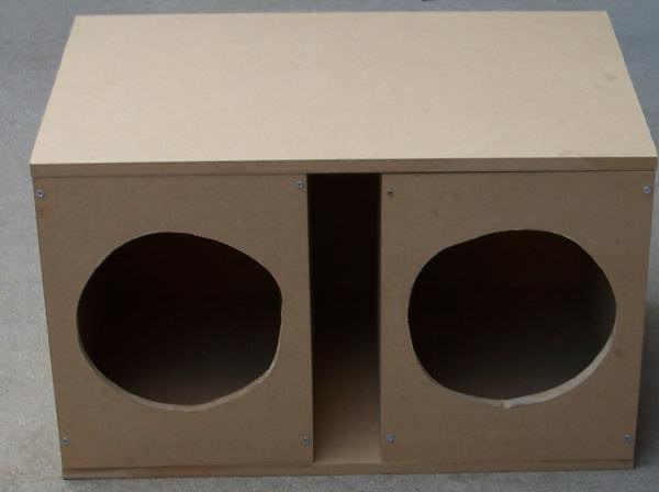

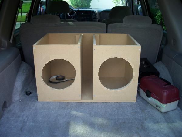

Bronze Member Username: BigharvPost Number: 48 Registered: Jun-07 | Ok i promised pics of my box, not like most of you care but heres to anyone who wanted to see the box i built. I didnt have any silicone caulk so i didn't get to finish it last night but my amp gets in tomorrow so hopefully the box will be done and ready to go when the amp gets here. As i was sanding this beast down there were some sweet spots that really made the box start resonating to the sound of the sander and it was glorious. 5 cu ft box tuned to 35hz half done sittin in the back of my ride from the top with the lid on top but not attached ![]() |
Platinum Member Username: BestmankindSQ = SoundSplinter RL-s Post Number: 14184 Registered: Oct-05 | box looks sick. i see you are not an expert with the jigsaw. awesome nonetheless. |
Gold Member Username: JblanfordPost Number: 1909 Registered: Oct-06 | jigsaw > you lol |
Gold Member Username: OglejustPost Number: 2279 Registered: Aug-06 | hahahahaha nice straighthand on ya |
Bronze Member Username: BigharvPost Number: 50 Registered: Jun-07 | yeah that was cut out with a sawzall, and that blade wasnt easy to turn. i couldnt find my jigsaw so thats what happens when your lazy |
Gold Member Username: Nyyfan13Fi SSD USA Post Number: 5467 Registered: Jul-06 | good looking box big harv....sub cut outs didnt come out too circular but good sh1t nonetheless |
Bronze Member Username: BigharvPost Number: 51 Registered: Jun-07 | FYI: The subs fit in the holes snug and it was my first box |
Gold Member Username: JblanfordPost Number: 1910 Registered: Oct-06 | other than the cut-outs the box looks really good |

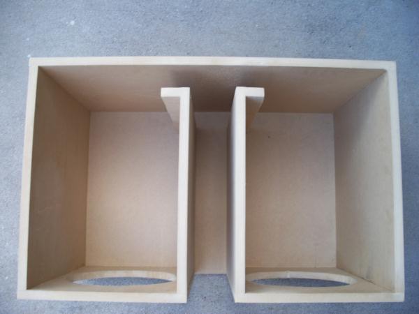

Gold Member Username: Crayola0Future 15 Wanger!!, Wisconsin Post Number: 1926 Registered: Jun-06 | might be the angle of the pic but the L shaped ports look very close to the back wall otherwise great box |
Gold Member Username: Tremor1127Team Fi Car Audio [:-] Post Number: 1897 Registered: Aug-06 | holy crap! sawzall FTMFW! |
Platinum Member Username: Rovin4 10 Pioneer... Post Number: 11797 Registered: Jul-05 | looks good but those circles = ........... ![]() |
Silver Member Username: BasssquaredKansas Post Number: 973 Registered: Nov-06 | LOL LMFAO HAHAHAHAHAHA i havent laughed this hard ever and i mean ever fix up them wholes Harv but besides that craftsmanship looks good |
Bronze Member Username: TejcurrentPost Number: 55 Registered: Apr-07 | Looks good for a sawzall cut, everything else looks much nicer. Just have to ask- you are putting more screws in than the 4 per panel I see right? |

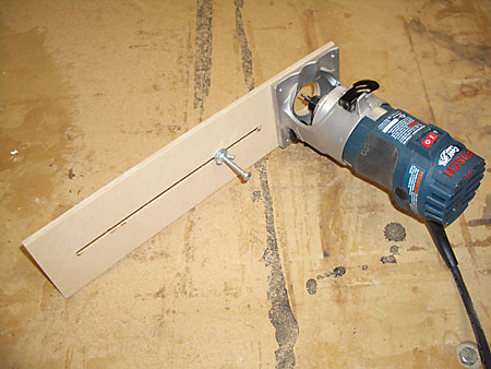

Silver Member Username: MesodummTri-City, Az Usa Post Number: 155 Registered: Apr-07 | I hope you can get you subs to actually seal in them holes! It might be worth your while to cut another face plate board and use a router to cut the hole! Take a strip of 1"x 12" metal and make a circle cutter.![]() |

Gold Member Username: WingmanaliveA pic is worth 1000 posts!! Post Number: 8416 Registered: Jun-06 | Good job for the effort, and like stated there are relatively easy wasys of cutting perfect circles. Personally I don't mind the large compass and jigsaw method. I have one that extends out to 24" or so. $10 at the Depot. If you make a living building boxes or are just tired of freehanding it a router jig works well and can be made easily as well as Mesodumm suggested. ![]() |

Silver Member Username: MesodummTri-City, Az Usa Post Number: 156 Registered: Apr-07 | Hey Big Harv your box is looking good espeacialy after you route the corners then it will look killer but please Man!!! Please!! just cut new front boards! Your sub has to seal perfectly if not you will have blow by which sounds like crap and wood putty will not do it, you need to understand how much pressure a sub can create. Here is a listing for a router it is a really good deal it looks like it has the guide for circle with it but I couldnt tell for sure, then you just need 2 bits a 1/4 straight and a round over and your set!! Or there is always Garage sales I have found many tools for way cheap. log on to your local paper and look for garage sales with tools! I found jigsaw, router, router bits, and nailer once for really good deal, so you can find really good deals!! Make us Proud!! redo those front boards!! You will feels better about your box for doing it!!!http://cgi.ebay.com/2HP-1-2-or-1-4-ELECTRIC-PLUNGE-ROUTER-UL-listed-1600W_W0QQitemZ180136537815QQihZ008QQcategoryZ20781QQrdZ1QQcmdZViewItem you can see by the circles I put in the box why we are concerned I have never seen a sub shaped like your holes, We are all just trying to help so don't get mad!! I don't want to see this go into a fry like pool boy got! I don't know what his name is now, I think he changed it! a couple of times! okay!! and defenently more screws 1 per 5" no less, I do 1 per 3" but thats me! With lots of glue! wipe off extra! Your doing good Big Harv keep it going! Thanks ![]() |

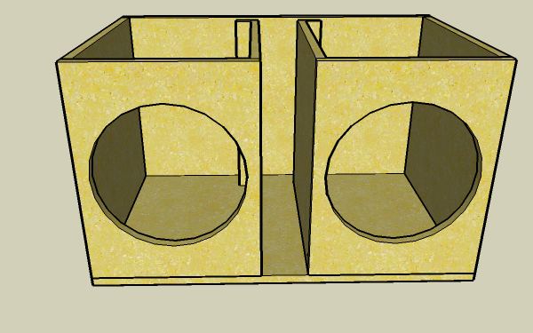

Bronze Member Username: BigharvPost Number: 54 Registered: Jun-07 | im gonna have to say my box looks pretty good compared to my sketchup model. so f@ck all you haters. |
