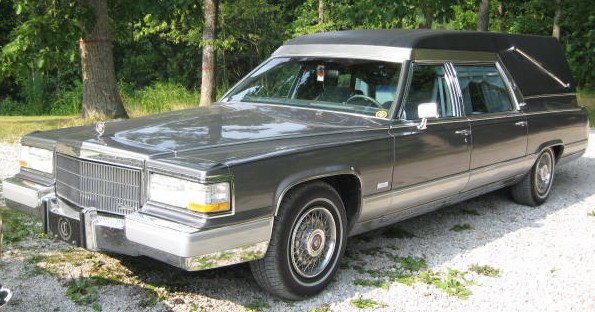

New member Username: JustcadaverKentucky Post Number: 1 Registered: Jul-07 | I drive a 1991 Miller Meter Hearse. It currently has a wood casket in the back sitting vacant, vacant for SUBS!!! I currently have this setup: JVC KD-S580 Direct Access CD-player 2 Memphis MClass 15-MC4.6 Speakers (Front Dash) 2 Memphis MClass 15-MC92 Speakers (Back in mobile Memphis Enclosure with quick disconnects apiece) I am looking to fill the casket with Subs. The ones I have in mind are: 4 Memphis Power Reference 15-PR15D4 1 Memphis Amp Power Reference Class D 16-PR1.1000. Would 4 subs be too many for the Amp? How large of a box do I need for each sub? Well would this setup work??? My goal is to have people hear me coming about a block or two away... Basically to go to car shows and make people go wow that sounds awesome. |

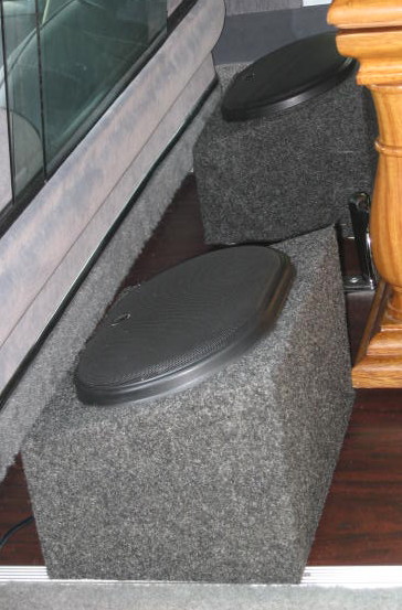

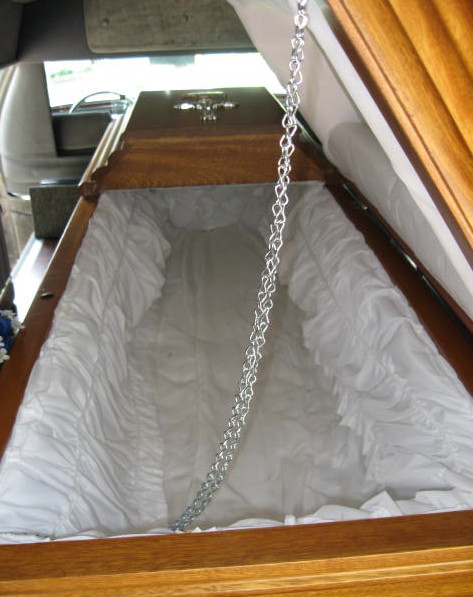

New member Username: JustcadaverKentucky Post Number: 4 Registered: Jul-07 | Just took some pictures: Driver Side Passenger Side with view of Quick disconnect and possible location of Amp. Inside view of Casket. Large enough for 4 subs? Picture of the vehicle. |

New member Username: JustcadaverKentucky Post Number: 6 Registered: Jul-07 | The casket has no padding at all in it just a thin fabric and the back of the hearse is all fiberglass, the section with the vinyl top. (suppose to save weight but it is still regestard at 6,850 lbs) If I add two more 15 subs what size amp would I need or would I run all 6 off of one amp??? Would I need two of the PR1.1000? Or would I just need a PR1.500 which has RMS Power 1 of 500X1 and the PR1.100? Which is best having either 500 extra RMS or haveing the exact RMS amount? TWiZTiD I'm around the Richmond area. |

Bronze Member Username: TejcurrentPost Number: 32 Registered: Apr-07 | What I was thinking was putting the 18 facing up. I'd rip out the stuffing in the casket and fiberglass the corners to make sure that it had a good strong air tight box. Then put a piece (or two of mdf over the top of the casket, similar to the pic JB put up, except put the amp at the foot where the 'cooling' was in the pic, with the amp flush mounted in the bottom. You could take the small section of the lid off the bottom of the box to keep from sealing the sub off, and allow air flow to the amp. Honestly with as much space as you have you could just mount the amp outside the box and port it with the sub/port facing up instead of damaging the box-though I don't know how that would sound. Just another idea to get more output out of the single sub (plus I like ported more). |

Bronze Member Username: JustcadaverKentucky Post Number: 19 Registered: Jul-07 | Why I only use my fingers and toes to count... LxWxH=area... I need more hands and feet... |
Bronze Member Username: TejcurrentPost Number: 51 Registered: Apr-07 | 74in Length 14in height 21in width For a volume of 21756in cubed. ^^ what happened to those dimensions? I'd use that space for a single Q, tuned around 32-35hz. You could make the port around 21x4". And I'd use 3/4" mdf, or 2 layers of 1/2 mdf pressed together to make 1" mdf. I like that amp on the lid idea, would be nice if you could accomodate for cooling. If you seal the Q it will still have enough space for you to put your amp in the bottom of the casket, but ported will have a lot more output. |
