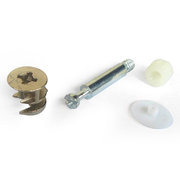

Silver Member Username: Koz1031Monticello, IN United states Post Number: 472 Registered: Jul-04 | Yes I read nick's answer, and forgot to thank him for that. May I suggest using the brackets that they use in furniture. You can get them at almost any hardware store. You could then predrill all the holes and put the box together along with gluing it inside the trunk. add a few screws and some glue and that should cover that. Your only other problem I can think of would be the carpeting of it. If you so desire. Tools need for the cam locks are a drill (preferably drill press) about a 9/32 drill and a forstner bit the size of the cam locks. I'm sure you know what I'm talkin about, and maybe ROVIN could explain it a little better than I. As I said just a thought. |

Silver Member Username: Koz1031Monticello, IN United states Post Number: 475 Registered: Jul-04 | They are called cam bolts. It's the little 2 piece mechanisms you use to put knockdown furniture together. I've been all over the net trying to find a pic of them with no success. But I'll find em somewhere. Well I'll try really really hard. I really think that's the ticket for you getting that big box in the trunk. Now it's back to bed I need some sleep. |
Silver Member Username: Koz1031Monticello, IN United states Post Number: 477 Registered: Jul-04 | Well I've been to 1143 different sites and still can't find a pic of the cam bolts. At this point about the only thing I can say is you have 2 alternatives. 1.--I would imagine you have a ACE Hardware where you live. I know ours carry them, so since it's a chain store I would assume yours would also. I would think all you would have to do is tell one of the people that you need cambolts, if they ask you what tell them the little alum. mechanisms for putting knockdown furniture together. 2.-- Go to Wal Mart--Target--Kmart, someplace like that and buy one of those cheap pieces of put it together furniture, take it home pull the nut and bolt bag out. Then you will have what you need. Take that back to Ace Hardware show them, so that it will ring a bell. (By the way a lumber yard or a Lowes--Home Depot--someplace like that should also have them. Take the original back home, put back in the bag and return the piece of furniture to wherever you got it from. I know our printer stand (that came from Wal Mart) is put together that way. they work great. You will have to take a little extra time to lay things out, because the hole location for the cam and the lock is pretty critical. But ease of putting things together is worth it. Sorry I couldn't be of more help. |
Gold Member Username: WingmanaliveA pic is worth 1000 posts!! Post Number: 8193 Registered: Jun-06 | I think koz is referring to a cam dowel and nut. Am I right? ![]() |
Silver Member Username: Koz1031Monticello, IN United states Post Number: 478 Registered: Jul-04 | That's them Where did you find that pic. Besides that don't you think that would be the answer to KiLLa's building the box in the trunk woes?? You don't really need the 2 plastic pieces. The larger of the 2 is just a coverup piece for the cam I belive the smaller of the 2 is a plastic threaded insert for the the cam dowel. You can use the dowel with or without. Anyway thanks for finding the pic Paul. I was about ready to learn how to put pics up on ecoustics. I got some of those out in the garage, and a digital. Well I hope that helps you out KiLLa |
Gold Member Username: WingmanaliveA pic is worth 1000 posts!! Post Number: 8207 Registered: Jun-06 | Hey, I'm the picman lol. Those are really very common in office type furniture. Will it serve a good purpose here? My guess would be no. High SPL tends to vibrate everything and I'm sure those connections would be in question. You would need a glued/screwed joint for best results. IMO! ![]() |

Silver Member Username: Koz1031Monticello, IN United states Post Number: 479 Registered: Jul-04 | That was my point exactly. I think I would use these just for ease of putting the box together, not to replace the glue and screw, although I am petty sure that you could do away with the screws. I would think that at the mating edges all you would have to do is run your bead of glue and then tighten the cam bolts like always. They should provide pressure to hold the box together until the glue sets up. Based on 1 thing I learned on this forum the screws don't hold the box together, the glue does. besides a drop of glue on the cams after they are tightened up should (I would think) would hold them in place. But this is all just my opinion. I just thought I'd throw the idea out there for consideration. Trying to think outside of the box so to speak, while still being in the box, literally. There seemed to be some concern of these breaking apart, or coming loose. If you look at it in these terms. Most boxes are put together in the conventional way using glue and screws. I know of no person that glues the screws that they use to put the box together. And I have never seen the screws in a box vibrate out. This being so in car/trucks hitting in the 140-160 range. But as I said b4 it was just an idea for use and ease of putting the box together. |
