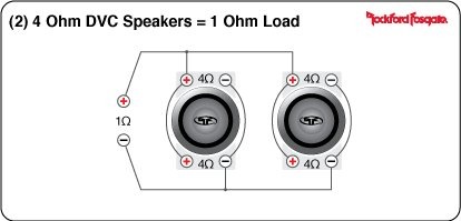

Gold Member Username: The_image_dynamicSan Diego Post Number: 2017 Registered: Dec-06 | |
Silver Member Username: ShowridesHartford, CT USA Post Number: 832 Registered: Feb-06 | said that isnt a valid email address? I am Showcarsite@gmail.com try me. |
Silver Member Username: Killer44Ontario Canada Post Number: 916 Registered: Dec-04 | ok sounds good showrides...and brad the pic u put up isnt showing up for me....? |
Gold Member Username: The_image_dynamicSan Diego Post Number: 2018 Registered: Dec-06 | ![]() |
Silver Member Username: Killer44Ontario Canada Post Number: 919 Registered: Dec-04 | showrides helped me out, and thanks brad im gunna wire em up like that tmrw and hopefully it goes good...thanks alot guys.. |

Silver Member Username: ShowridesHartford, CT USA Post Number: 833 Registered: Feb-06 | Yeah, with the amp running at a final load of 1 ohm now instead of 4 ohms, things should get a little louder in there.![]() |
