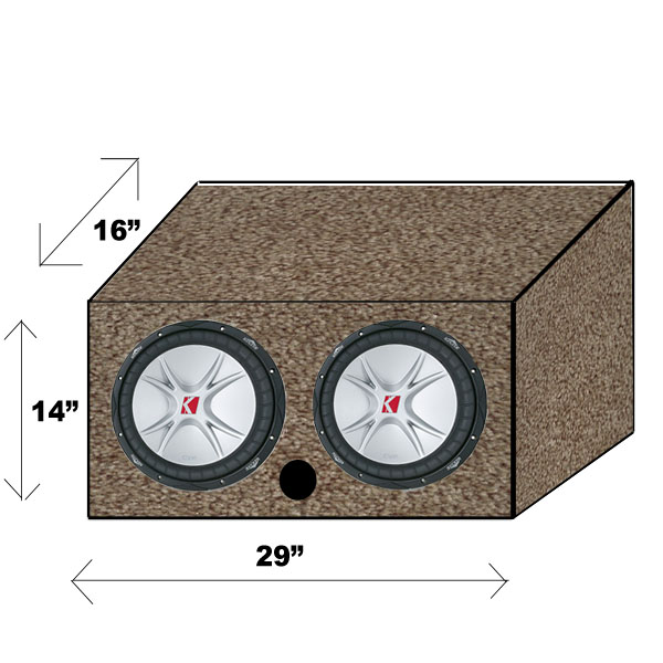

K so my problem is i have this box design and i need to know 1) if it works ok, and 2) if the port is alright, and i need the size and demensions of the port, and if i should have two and anything else you can tell me.
The subs are 2 12" Kicker CompVR's (this is a rough sketch from Photoshop.)
Anything that i might have forgotten (courtesy of Crutchfield)

dont forget to consider sub\port\s displacement
i would do 2 4" aeroports ........

k and does placement matter?
Username: Logan__tille
I make it rain.
Post Number: 8166
Yes.
Username: Jasonsue22
WA
Post Number: 21
where should i put the ports then?
