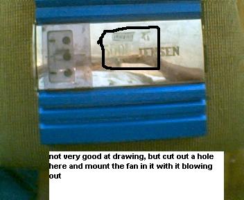

not trying to jack the thread, but HOW would I put a fan on my amp? the damn thing gets too hot and cuts itself off occassionaly...then what should I expect from a FREE Jensen..lol

well,what i meant is that I would probably take the top off, cut a space out in it, mount the fan so that it blows outwards, and then wire it up.
since I got pics of the amp.....look at my idea below

btw, the slots that are shown in the bottom pic, if I have my rear seat down, and the amp is cutting out, I can blow in them, and it will come back on...so if I can get air flowing in throught them and out the amp, that should cool things down enough to keep it from cutting off, hopefully

Yep, there you go.

so how powerful of a fan would I need, or will all 12volt fans be the same? and HOW do I go about cutting the hole?

Cut the hole using a dremel.

and IF I dont have a dremel?

Seal those air vents off and however you end up cutting it, make damn sure you clean all of the metal off of the circuit board or whatever is underneath that top panel. If worse came to worst you could drill multiple holes and tap the rest through with a flat screwdriver and a hammer.

I'll take the cover OFF to cut it. so I wont have to worry about metal shards

I meant after, all it takes is one little shard to cause a short but you can make sure there are none left by filing the cut. But just check to make sure nothing falls inside after you replace the top.
