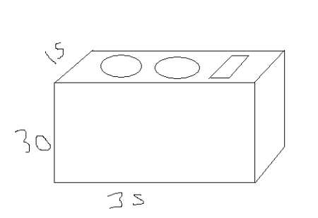

But are you looking for a box that is like this?

it would only let me view my most recent posts, not delete them, sorry =/. L.B. Are you interested in a box like the one i doodled above? If so, what would you like your box to be tuned to, and I can sketch a more defined portrayal of what your box will look like. Let me know, thanks.

Your sketch is almost done, but I ran into one problem. The box must be bigger at least 15.375 wide, instead of 15, because your sub cutout won't fit within those parameters. Mind if it's 16" instead of 15"?
Username: Cried
Erie, PA US
Post Number: 270
LoudBlazer Box Design [2x CompVR 15]
Dimensions: 35" x 16" x 30"
Port Area: 58in^2
Port Width: 4in
Port Height: 14.5in
Port Depth: 7.66in
Frequency: 35Hz

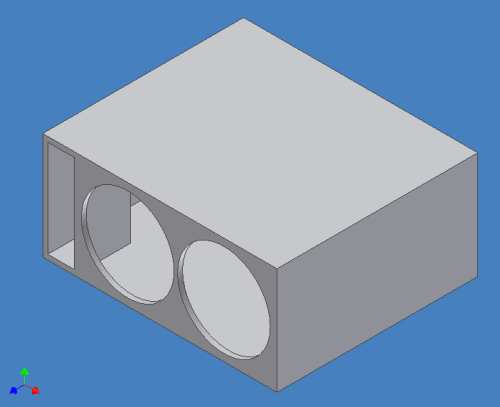

ok well those are all the same box. I misunderstood how you wanted your subs and port. You just want me to move them to the top of the box instead of the front of the box? I'll change that and repost and you tell me if its right.
Username: Cried
Erie, PA US
Post Number: 278
Would something like this suit your needs?
Port Area: 106.875in^2
Port Width: 3.75in
Port Height: 28.5in
Port Length: 19in
Frequency: 35Hz

Would this work better?
Still tuned to the same frequency as the boxes above, just a different port position and port area, still same port width of 3.75"

how many cu. ft. is that box?
Username: Insearchofbass
Post Number: 5321
8.01 cubic feet total 33.5 x 14.5 x 28.5 internal
Username: Cried
Erie, PA US
Post Number: 295
around 8 cubes not including sub displacment or port displacment, i couldnt find the sub displacment of the CVR15's. If you can get those, subtract that number twice from 8cubic feet to get the displacment of the subs, and then I can figure out the port displacment.
Post Number: 5322
probably be around 7.00 cubes left after sub and port displacements
