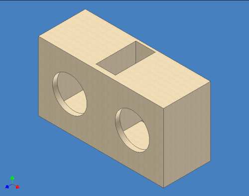

FINALLY! After 2 days of downloading and 4 hours of installation, I got a CAD software on my CPU, so I can put my drafting skills to the test when it comes to designing boxes. Let me know what you guys think and if anyone needs one done, I'd be happy to ;).
This box is:
Dimensions: 40" x 22" x 14.25" [Double Baffle]
Volume: 5 Cubic Feet
Tuning Frequency: 40 Hz
Port Width: 6.2"
Port Length: 13"

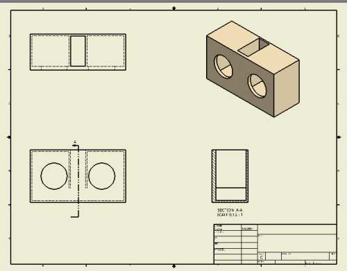

Here is a drawing with orthographis projections of the part in: TOP, FRONT, ISO, SECTION VIEW
[Im just having fun, let me know what you guys think]

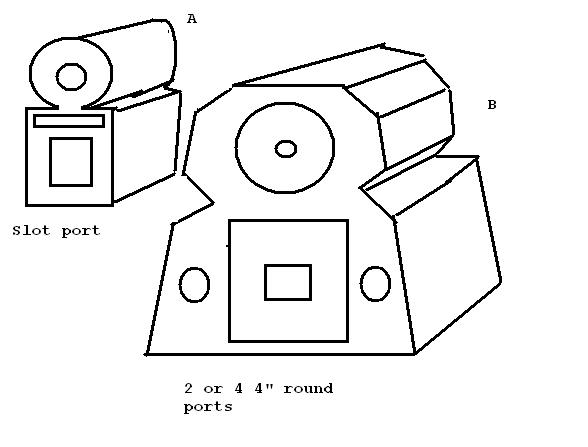

Ok, What can you do for,
A: 2 12" JL W6v2 Tuned to 35. Would like to keep it under 6-7 cube
B: A ported box for a L7 15, AND a sealed box for a single W6. About 3.5 cubes Kicker Box tuned to 30, W6 box, Well its sealed, so say 1.5 cubes
Now this B box Should be one unit. Kicker on the bottom, JL on the top.
Heres a couple of sketches of the combo box. Box A is a slot port, Box B is 2-4 round ports.
So, What can you do?
Also, The top JL box needs to be kerfed fot the round effects.
BTW, Nice program. Kinda like Cannons.
What?
Username: Cried
Erie, PA US
Post Number: 236
sh!t man, nothing simple? Lol j/k. I dont get those sketches at all, I've never seen a box that looks anything close to that, so idk how I would go about calculating anything for it. If you can give me some dimensions and maybe find me a pic we can go from there.
Username: Van_man
Boston South, MA
Post Number: 2535
Well, Demensions are variable. I am not constriced by size. Treat the combo box as 2 seprerate boxes. So lets say the L7 box is 24 -30 wide X 24 -30 High X 24-30 deep. I would like to keep it square with a even space around the sub. Like 4"-8" on the side ,top. Port(s) and sub facing front. As far as the JL box, Whatever the kicker box dictates as far as depth, but again a uniform size around the sub that compliments the size around the L7.

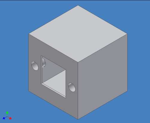

L7 Box
28" x 28" x 28"
Tuned to 30Hz
(2) 4" Diameter Ports 4.06" long

nice box.
Username: Cried
Erie, PA US
Post Number: 243
lol thanks, but its over 10 cubes ^^
Username: Van_man
Boston South, MA
Post Number: 2539
Yea, I know, I ran the numbers, Lol, I just didnt think it was important to share. Thanks for the efforts. At least it bumps for ya. Whats that BBP6 you got?

btw, that box you made is actually 12.34 cubes.

lol marc 83's are for noobs i got the 84, plus did you take into account 3/4" MDF, I used the12volt volume calculator, I think its pretty accurate. That was 10.3823482758347 cubes without taking into account the port/sub displacment.
