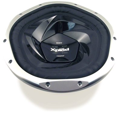

i rewired everything yesterday and its a SPL Z2X1600 1600 watt amp and the photo is the type of 12's and as the ohms go how do i find out which ohms they are Upload

do you have an ohm meter? if so disconnect the speakers from the amp and ohm the speaker. Otherwise you will have to look up the model number or remove the speaker from the box and look on the back of it. that amp can handle 4 ohms bridged and two ohm stereo. try only hooking 1 speaker up to it and see if that works. if it does then you will probably need to wire the subs up in stereo instead of bridged.

no i dont have the meter should i buy one.but the amp says its capable of 2ohm and it stays on mono i cant switch to stereo what if i put the head unit on mono to do you think that would help and what size fuses do you think i need for this amp because someone told me 40's and theres 3 30's in it now.and i really appreciate the help thank you and the model of the subs are xs-l123p5b

just look on the back of the subs it should say like DVC4ohm or something like that

okay that sub is single voice coil 4 ohm. you need to wire one sub to each channel on the amp. in other words wire one sub to the right output on the amp and the other sub to the left output of the amp. if there is only one wire coming from your sub box then you need run another one. another option would be to get a 2ohm stable mono amp.
